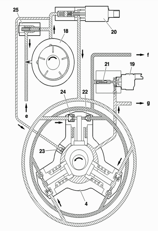

High Pressure Fuel Pump
Operation Phase
Transfer pump (pre-supply)
The transfer (pre-supply) pump is a volumetric pump integral to the fuel high pressure pump.
The absolute pressure is between 0,7 and 1,5 bars as the fuel enters the transfer pump.

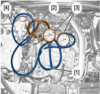

Tooling:
Connect the tool [1]between the booster pump and the fuel filter (white marking on the fuel supply pipe).
Connect the tool [2]downstream from the diesel injectors, between the high pressure fuel pump and the fuel filter (green marking on the fuel return pipe).
Connect tool [3]on tool [1]or on tool [2].
CAUTION: Any pressure checks downstream of the fuel filter are prohibited.
N.B.: For dynamic testing of pressures: insert the extension [4]between the pressure gauge [3]and tools [1]and [2].

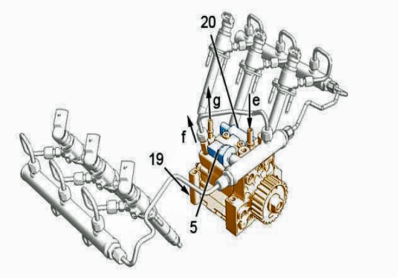

| (16) Fuel filter. (17) Sensor for presence of water in diesel fuel. "d" Aperture not used. Direction of fuel circulation (as per arrows): "b" Fuel inlet: The fuel comes from the tank and from the thermostatic valve when the engine is cold (click-fit connection). "c" Fuel outlet: Towards the fuel high pressure pump and the tank return pipe (click-fit connection) |
- The engine management ECU checks the pressure of the diesel fuel in the fuel high pressure common injection rail in a closed loop via the fuel pressure sensor.
- The engine ECU uses the fuel pressure regulator (1322) to manage the pressure of fuel inside the fuel high pressure common injection rail.
- The engine ECU pilots the fuel volume regulator by sending a modulated power of the form of OCR.
- If the OCR signal is small, the fuel volume regulator allows a large quantity of fuel to go towards the fuel high pressure pump.
- If the OCR signal is big, the fuel volume regulator allows a small quantity of fuel to go towards the fuel high pressure pump.
| "e" Fuel inlet into the transfer pump. "f" Fuel outlet from the high pressure pump towards the fuel high pressure common rail. "g" Fuel return from the high pressure pump towards the fuel tank. (5) High pressure fuel sensor. (19) Fuel pressure regulator. (20) Fuel volume regulator. |
Tooling:
| Ø 10 mm union for low pressure plug 4215-T. | Ø 8 mm union for low pressure plug 4218-T. |
| Pressure gauge for checking the turbocharging pressure 4073-T.A (kit 4073-T). | [4] Extension 4251-T. |
