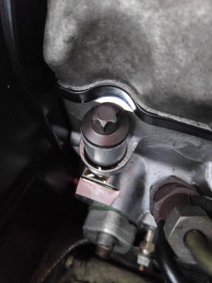

Hi guys, is there a way to check the crankcase breather valve.
I took it off and could easily blow through it from both sides. Is this normally the way it should be?
Just to be sure, guess it's this part.

I have a similar one on XM, which removes crankcase (oily) fumes from the rocker cover, and vents to intake duct (low suction). Have had ours leak oil, because of a poor O-ring seal where it slots into the intake duct, and a slightly sloppy fit.
Never investigated the inner workings, although a good few petrol ones explained on the web, where the flow through (usually rocker cover to high-vacuum inlet manifold) is variably metered according to engine revs. The diesel versions may be a whole lot simpler, and maybe even just a one-way valve (spring+diaphragm).
Someone here will surely know!

Mine on the BX blew both ways with a gauze filter in the middle

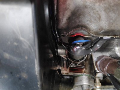

I had some leakage at the left side of the seal after 100km, so I tightened the left bolt. Everything looked good for about another 100km. Then things went terribly wrong and the cover seal was torn to pieces during my trip back home.
Did I overtighten the rocker cover?
Hopefully nothing more is broken as I drove about a km slowly while the oil lamp went on and off, before being able to park and refill oil. Then slowly home.
Will need to clean a lot.
Going to try to replace the seal again ASAP. How tight should be tight enough? Other advise?
Feeling embarrassed!

Bad luck. You'll need to replace that seal again, preferably with another new one.
You might be lucky and be able to clean it up though, and de-oil it.
Get hold of a tube of Hylomar Blue (it's on Amazon).
Clean all the surfaces with solvent (alcohol, petrol...) and apply the Blue thinly to all surfaces (small brush).
Allow to dry off (15-30mins).
You can then position the seal, and it will stay where you put it. Blue works like a post-it note: it stays put, but is separable and repositionable. Can be separated later, if needed.
Tighten down evenly, but don't overdo it.

I used Loctite si 5926 silicone blue. Is that also okay to use?
I only put a thin line on the head.
Then I positioned the seal on the cover without the Loctite.
Then I carefully placed the cover on the line of Loctite and tightened the 3 bolts.
I really did not have the idea that it was too tight but it looks like the cover cut completely through the seal. I know for sure when I remove it.
Really, I'm not that strong so I'm confused that this might be too tight.
Q's:
Is it okay to use the Loctite?
Should I put the silicon on both sides of the seal?
Should it be a thin line or just a very thin film (like putting it on with a finger)?
How do I know that the bolts are tight enough to not leak and not to tight to destroy the seal?

The tightening torque for the valve cover is stated in Haynes as 2Nm (1.5 lb.ft), so quite a low figure.
This is to avoid distortion and gasket 'squelch'.
I don't know that Loctite sealant, but it's a silicone one, with a 24hr curing time.
That suggests it remains fluid - and slippery - for a good while, which isn't helpful if there's a risk of the gasket slipping out from between the two surfaces.
The Loctite fluid is also recommended for metal-to-metal work (like cast some cast engine sumps), where gasket slip isn't a consideration.
Silicone products are also not usually good at staying adhered to hot/oily surfaces.
The advantage of the Hylomar Blue (and there may be other similar products) is that it goes from thick liquid to a tacky Post-It like surface quite quickly (eg 10-15 mins), and the grip available is useful in preventing flexible gaskets from 'slipping away'.

Not sure about that. If the breather valve (in your photo) were stuck closed, it could allow pressure to build up in the crankcase, but a wet or blocky air filter would actually increase intake suction, and assist with crankcase fumes removal.

New seal placed. Let's hope this will hold for a while. Going to inspect during the upcoming weeks if there are other places that leak.
For now I checked the breather valve which was open to both sides. So no pressure build-up there.

On the breather valves, I wonder whether there are more than one type of these - some with a simple wire mesh (catcher, drip-back), and others with some kind of one-way or pressure diaphragm ?
