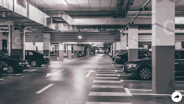

Re: Driver Comfort on 2013 C5 Tourer
They don't Paul - I don't know where you've got that from?
Getting in the car and either turning the ignition on or starting the engine does NOT deploy the mirrors on the X7 if they have been manually retracted using the internal fold back switch.
So they stay folded unless the manual switch is used again to deploy them. So that would make sense if you wanted them to remain folded regardless.
In my car park example if you are in a narrow bay with a large concrete pillar by the door and it's a tight squeeze, I would not want to unlock the car and have the mirror fold out potentially into the concrete post or part of somebody elses vehicle until it was save to deploy them.
These pillars can come right up to the where the mirrors are and there are worse examples of car parks in some places I have been in.
