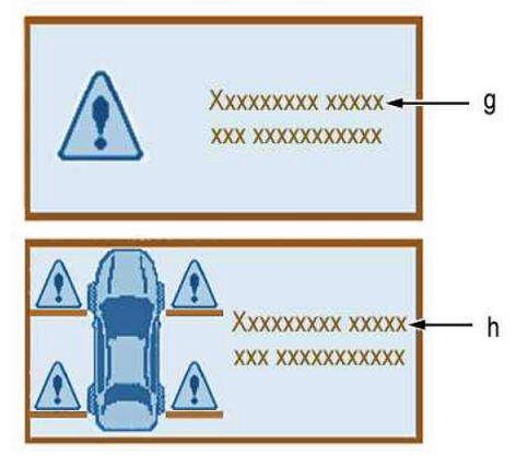

f you are getting dashes, when pressing the check button - be aware that after 20 days of not being used / operated it initialises itself and you will get these dashes displayed whilst it works out what is going on.
If there is a monitoring fault, the display will change thus:
"g" Several tyres not monitored.
"h" Wheel pressures not monitored.
Not all the sensors are the same. Although you can get these on the aftermarket - make sure they are still the correct part number. The newer replacement sensor part for the C5 X7 is 5430T4. I had all mine replaced with the later ones after a complete TPMS valve exploded out of the wheel like a bullet! It was the galvanic corrosion of dissimilar metals that was the problem. Also watch out and make sure that tyre fitters don't fit brass cores to the stems as this can have the same effect.
I would go for a drive first to allow the system to calibrate itself and see if that makes a difference - especially if the they have not been active for some time - but if they are not being monitored, then that warning should be displayed on your panel.
