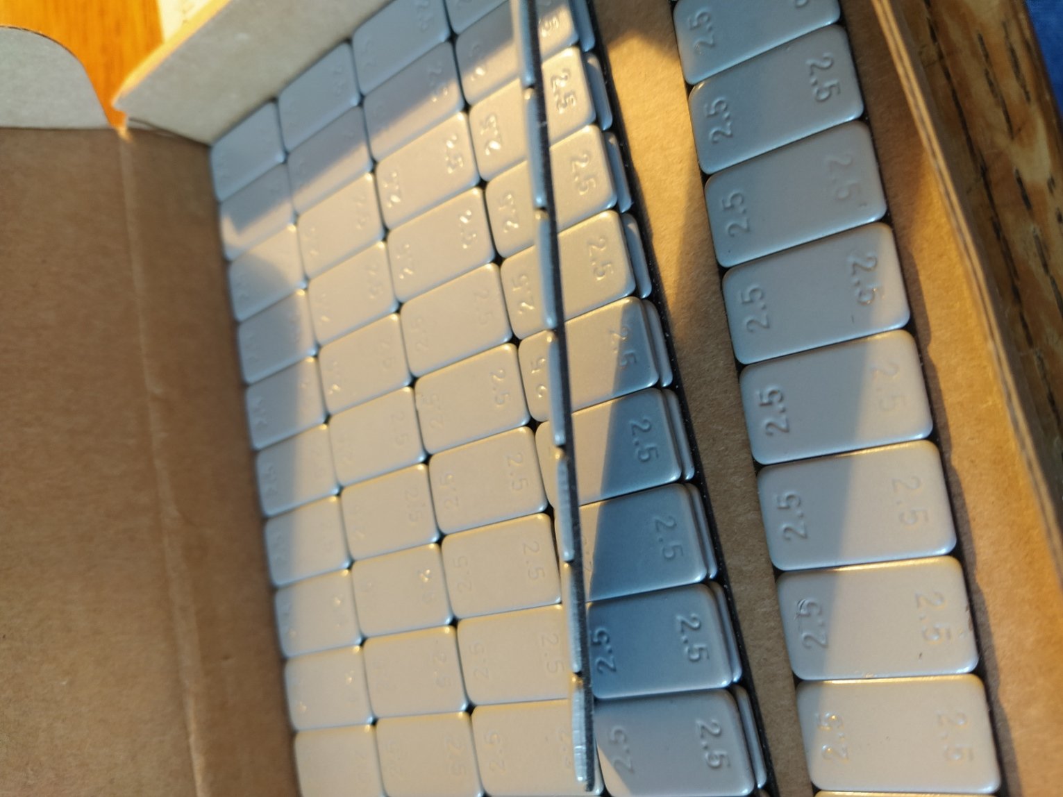

Ive got new tyres being fitted next week and have ordered the 2.2mm Trax Stick on weights from the bay. The current weights fitted are 3.76 including adhesive strip and just scrape the brake caliper when fiited in the position you describe. Really hoping these Trax weights are the answer!
Will let you know how I get on....
jamesnoble
Posts: 19
Joined: 05 May 2015, 22:45
x 1
Re: CX Wheel Weights
Unread post by jamesnoble »
Weights have arrived 2.27mm including tape!

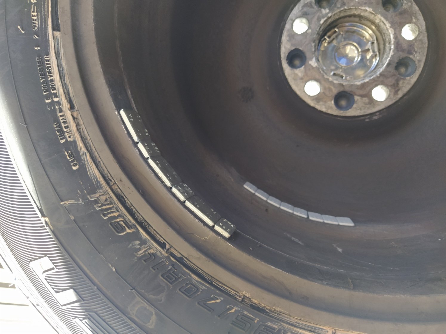

So, new tyres fitted today and slim weights used. Success! No more visible weights and beautiful balanced wheels!!!!!!!!!!!!!!!!
Whats nice is you can see how thick normal stick ons are comapred to the ultra slim. Amazing!
