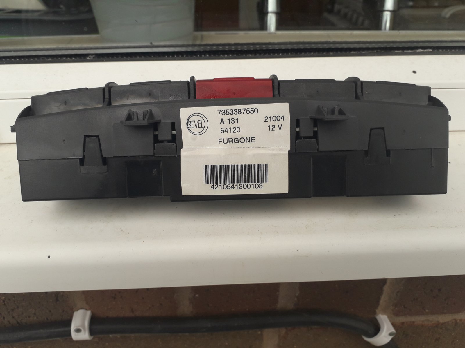

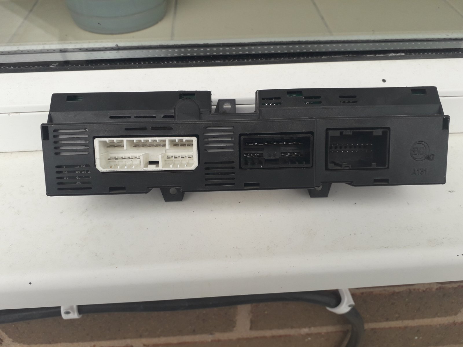

I have got the "a193" unit out. On taking it apart I have found that the fog light switch is faulty. This unit also incorporates the control over the main beam and oil level diplay on the dash amongst other things. Not only is the switch for the fog light faulty but the circuitry is faulty. If you think about it, the fog light circuitry has to be in line with the dipped beam as when the fog lights are on and you switch to high beam the fog lights go off. There could be a link. Anyway, this circuitry seems to be involved/controlling a lot of things. I have ordered a new one and if it fixes the problem I will come back to the forum. Just a point. If you look at the identity stickers closely on the back of the unit it refers to the unit as A131 not a193 as stated by the advisor on just answer?.

I think that's just a complete coincidence that the numbers are similar, A193 is the component code allocated by Autodata. They are pretty standardised codes across all makes & models on Autodata.bnd wrote: 01 May 2020, 11:21 Just a point. If you look at the idennty stickers closely on the back of the unit it referes to the unit as A131 not a193 as stated by the advisor on just answer?.

Re: Citroen Relay 2.2 2004 dip beam and dash light problem
Just in case some here is experiencing the same problems, further to my investigations the following infirmation may help....
I have found out that on these 2002 -2006 Citroen relay, Peugeot boxer and Fiat Ducato vans that an earth is supplied from the indicator/lights switch to an electronic module known as the a193 unit (see above photos). This unit in turn should supply a earth connection to relay T02 located in the relay/fuse box under the bonnet.This module also switches earths for the main beam lamps and the rear fog lights. Hope this helps someone.
