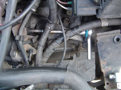

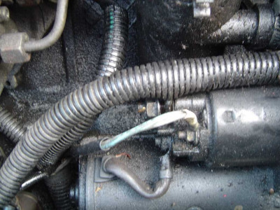

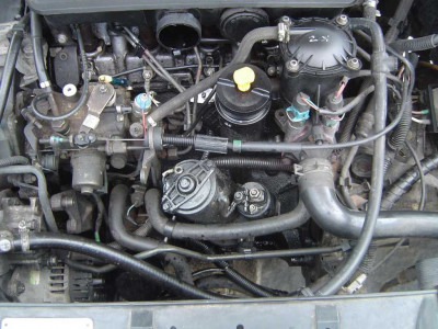

Re: Sticking solenoid Xantia
Its easy, here's a pic of what it looks like with an engine out of the car (note mine's a 1.9 non-turbo Diesel in a 405, essentially the same though)
You'll need a
H6 Hex, two bolts on the top, one at the bottom
13mm for the main Feed
8mm for the Solenoid Feed (or is it 6mm, Hmm?)
And check beforehand which way you're gonna physically remove the Unit once its unbolted.
You'll likely notice that the pics have been taken on different occasions

You'll need a
