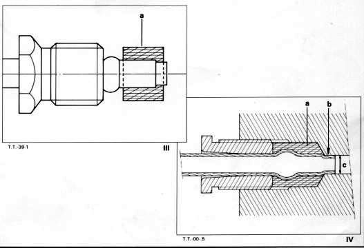

- x 1746
Re: The curse has struck again
This is Citroen's hydraulic coupling for 3.5 and 4.5mm pipes, and totally leak-proof.
Something similar might be possible for a larger fitting.
Just an idea.
The clever bit is that the rubber sleeve actually tightens its seal as the pressure increases.
The 'olive' is actually swaged into the pipe, and not a loose one.
Soft metal (brass, thin steel) olives cannot be used on steel pipes, as they do not embed. A loose olive must be harder than the pipe, so that it does.
Just an idea.
