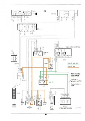

LH & RH is always (for all parts) as seen from the driver's seat.
You've done the Fast speed test, so that's ok.
In Fast speed, the two fans are in parallel, so even if one of then was duff (open circuit), the other one will work, full speed.
If one fan is 'weak' (stiff, or stuck/worn brushes)
- (a) the other will work
- (b) the full 12v applied to it might well overcome stiffness (or poor bush contact) and get it going, fast.
Now, Slow speed...
Here, the fans are in series, and
1 - both have to be in decent condition, as the current flows though each in turn + •—FAN?FAN—• – .
2 - the voltage across each fan is only half the normal 12v (so they run at slower speed), and for that reason a stiff or lazy fan might (i) not turn at all, but allow the other one to function, or (ii) might not turn at all, and prevent the other one from operating.
For Slow speed, BOTH fans must be in decent working condition.
To trigger Slow speed...
...power up Relay #1502 by Grounding its pin 2 (the 1550 line from the ECU)
Do this by applying +12 to relay pin 1, and Gnd to pin 2.
This will turn the relay on, and should make the fans run at Slow speed.
Note - You can do this with IGN OFF, and with the double relay #1304 unplugged, if you wish.
Try that, when you can, and fill in the usual Report. :wink:
If you do have a lazy fan, you might have to nudge it for it and the other one to work.

Re: Xantia A/C
The test described above (unplug double relay, and power up the relay) doesn't require the engine to be run, nor got up to temperature. Could help.
Have re-labelled the circuit diagram in two places: WTCU now also labelled Injection ECU, and the RH fan properly labelled (there were two LH ones! #-o).
