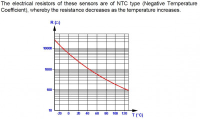

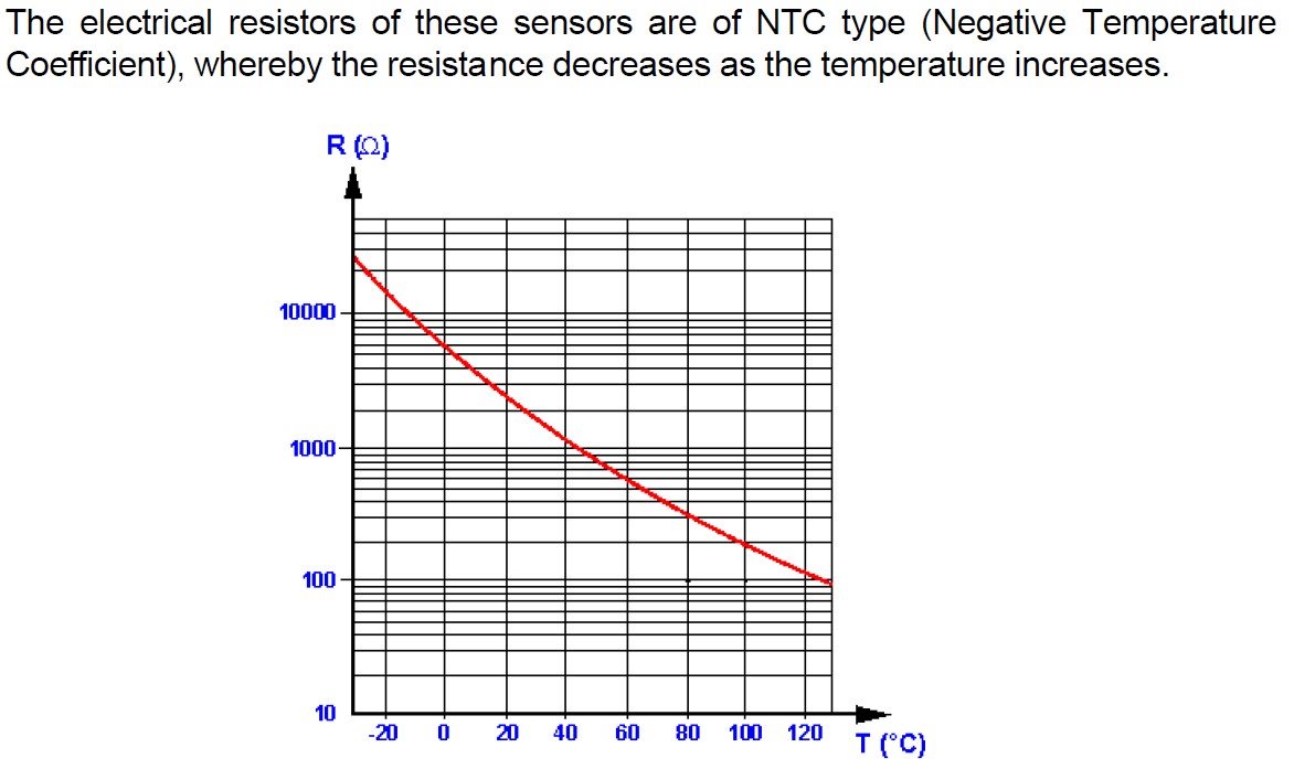

Lets go back a step here, why are you going to replace the sensor?
What happened when you disconnected it is totally normal, doesent sound like there is anything wrong with the sensor to me.
Yes its certainly not unknown for PSA coolant temp sensors to fail, I've replaced more than I can count over the years but when these NTC sensors go faulty the almost always cause the cooling fan to come on full speed, tell you the engine is overheating when its not & very difficult starting when cold. The system is designed to fail safe if the sensor goes faulty.
Do you have access to live data on a diagnostic reader? that's the easiest wat to see what the sensor is doing. If not you can use the table below to check the resistance at a given temperature.

That looks interesting, I'll check it with my multitester and let you know. Thank you again!
