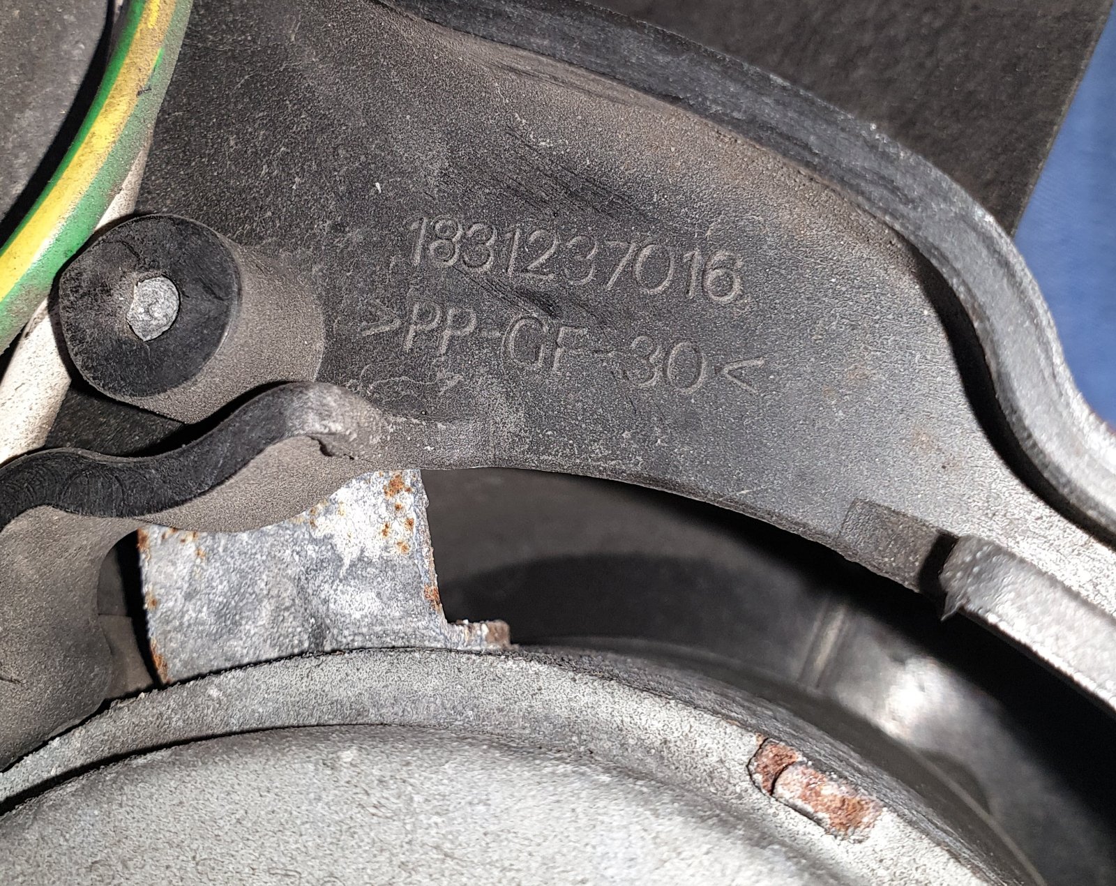

Re: Radiator Fan NOT Working Xsara Picasso 1.8sx 2003
That looks like a flap over the wires not a plug, so yes you did well not to pull it out .
I think it maybe blade type pins crimped on the wires so maybe worth opening up and checking if you get no joy elsewhere as a dodgy contact there may cause issues.

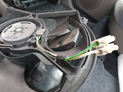

I just connected a 12v car bulb to the fan block connector and with the engine running I switched on the A/C. The bulb lit but as before the fan made not effort to turn unless I gave it a gentle push. I checked the voltage across the block connector with multi-tester and got a reading of 14v with the bulb illuminated. Interestingly when I switched off the A/C the fan increased speed quite a bit before slowing down and stopping, something it has not done before. There is no play or roughness in the bearings so I'm still not sure if the fan is weak or its something else, but I need to make a decision soon.

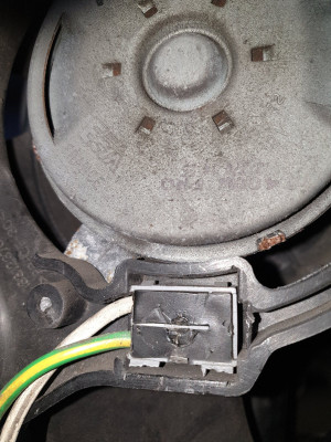

Just had another look at the "plug " on the back of the fan.
It may just be my weird logic but is there a plug on the fan itself that plugs into the wires "plug", would make sense as you can change the fans and not interfere with the wiring loom ?
Sticking brushes so not enough power to get up and go once started its ok or not enough power at the plug ?
Chris if you look closer at the pic of the fan first post on this page you can see the signs of plug opposite the wires/plug on the housing.
Memory/logic states that the fans are interchangeable, they must have a way to get power and by default cannot be hard wired, so there must be a plug/connector that maybe we are over looking ?
Mike, agree, there must be a connector somewhere that allows the fan itself to be removed.
Likely that flat widget on the fan itself.
That should be check out first, and then the fan dismantled if no joy.
Symptoms are a poor contact - either comnection or motor brushes.

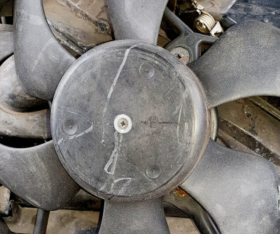

I think that you may find that removing the fan blade gives access to the screws that hold the motor into the housing.
Note that if the blade is held to the shaft with a screw, it is probably LEFT HAND THREAD.
Good advice and I will also take a look under the front plastic cover which has a center screw.
That screw is the one which probably is left hand thread, so be careful when attempting to remove it.
