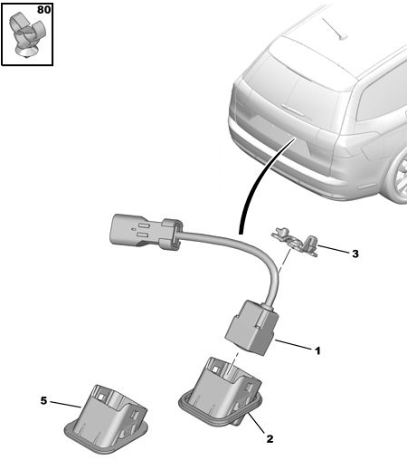

That's something there is very little on in the way of technical info from PSA. The wiring has to match one of the several Video pinouts at the back of the RT6. The Citroen Camera plugs directly into a socket as can be seen on the diagram, so I suspect it would be a matter of trying it and see - here are the original parts and price for a replacement in case it goes toes up!

Ok, so the original camera was part number: 98 040 403 XT
The replacement camera was the one I quoted in my last post: 98 135 828 XT (as I always quote the latest superseded part numbers) for enquiries.
However the actual RT6 units may have differed on later models as there are quite a few variants. But Even for the models with SMEG Touchscreens, the camera part number is the same.
