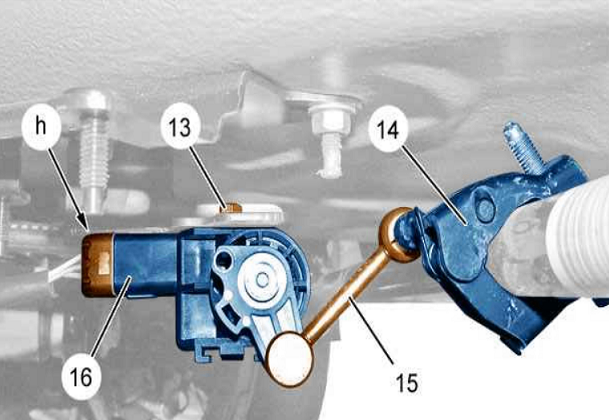

The clamp should never be adjusted normally as the slightest movement can make a big difference Gino, - so yes to your question - it is that sensitive. The clamp is only used initially when setting the vehicle heights at factory. Diagbox is only used for fine tuning the heights within a small range of movement.
If the clamp has to be moved for whatever reason, its position should always be clearly marked beforehand, so it can be replaced in the identical position. There is no positional data for the clamp that I have - only on height measuring for the fine tuning of the vehicle using Diagbox. So I can't help you with this - but if you can get it to a dealer they may have something or be able to set it up correctly - they will probably be able to find out the info from France if they don't have it locally.
The picture below may help as a very rough guide as to its position - but of course won't be accurate.
Procedure for removal and refitting for future reference:
Disconnect the connector (at "h").
Uncouple the rod (15) from the lever (14).
Remove:
  • The (13) bolt
  • The beam height rear sensor (16)
Refitting
Refit:
  • The (1) bolt, tighten to 0,4 ± 0,1 daN.m
Couple the rod (15) on the lever (14).
Connect the connector (at "h").
Return the vehicle to its wheels.

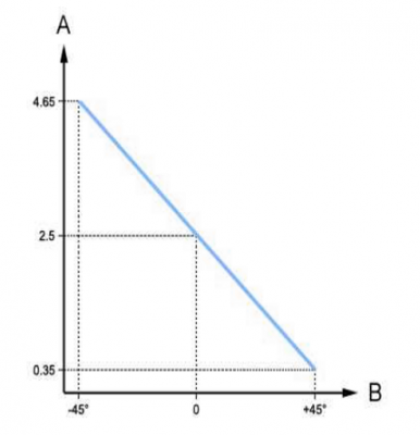

On the 4 Cylinder X7, the only data I have on the height sensor is the following:
"A" is the output voltage of the Body Height Sensor
"B" is the angle of the Body Height Sensor.
A negative value of the angle of the body height sensor corresponds to compression of the suspension.
A positive value of the angle of the body height sensor corresponds to release of the suspension.
So I'm not sure how this if going to help you any as the sensor will always connect up to the same position that the clamp is fixed at when the 'dog bone' is attached, so there is nothing to change in the sensor itself - as that only changes when the rear rises or lowers of course.
Your issue is with the clamp, not the sensor, so you'll need to reattach the sensor and dog bone and finely adjust the clamp by millimetres at a time until Diagbox shows the height settings as close to the height reference values as possible. That's my only suggestion outside of getting the dealer to do it.
The issue is ensuring it is at the correct height to start with though - and that is your problem if the vehicle is not sat right as it is. At least in the dealers they can do the height measurements and get the vehicle on a 4 post lift and lower the car down to the correct height gradually when the wheels make contact with the ground - gradually lowering it with the lift until they get it at the correct height, tighten up the clamp and then check the fine tuning with Diagbox.
