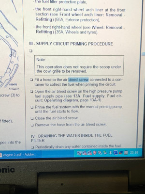

Also with regards bleeding the system im working from a workshop manual it refers to a bleed screw, just wondering where exactly that is located?
There is this but its not really a screw and i dont know how to use it:
Starting issues 1.5 K9K Modus

Have you tried priming the engine in the morning before starting it ?
It does sound like air is getting into the system and draining fuel back to the tank and the long starting time is where the system is priming itself and self bleeding.
