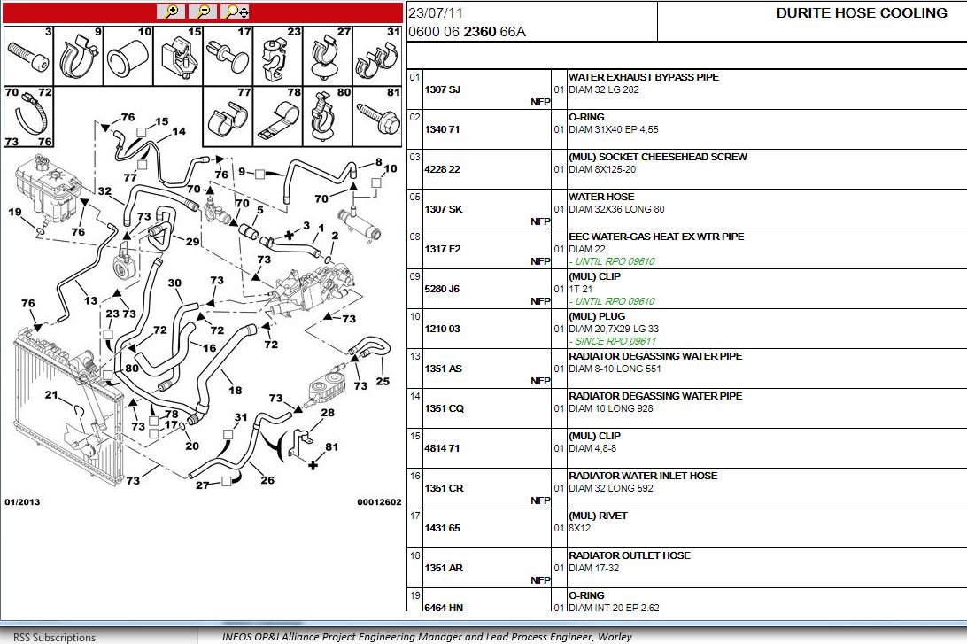

I have just replaced the engine stabilizer mounting on my 2.2 HDi and unfortunately while manouvering the coolant tank I have broken the nylon end of the coolant vent pipe which runs along the front of the engine connecting the venting tank to the piping at the other end of the engine. I have fashioned a temporary repair with self amalgamating tape but I would like to replace the whole pipe if I can source a new one. I have the two small hoses at either end but it is the semi rigid connecting pipe which now has a sheared off end that I need. Any help would be appreciated. :)
Item 14? Not showing as NFP and only £31.51.....

Thanks Richard, yes 14 is the pipe I meant. Sorry for being dumb but NFP? :-D

No effing possibility!
i.e. not (or no longer) available.
