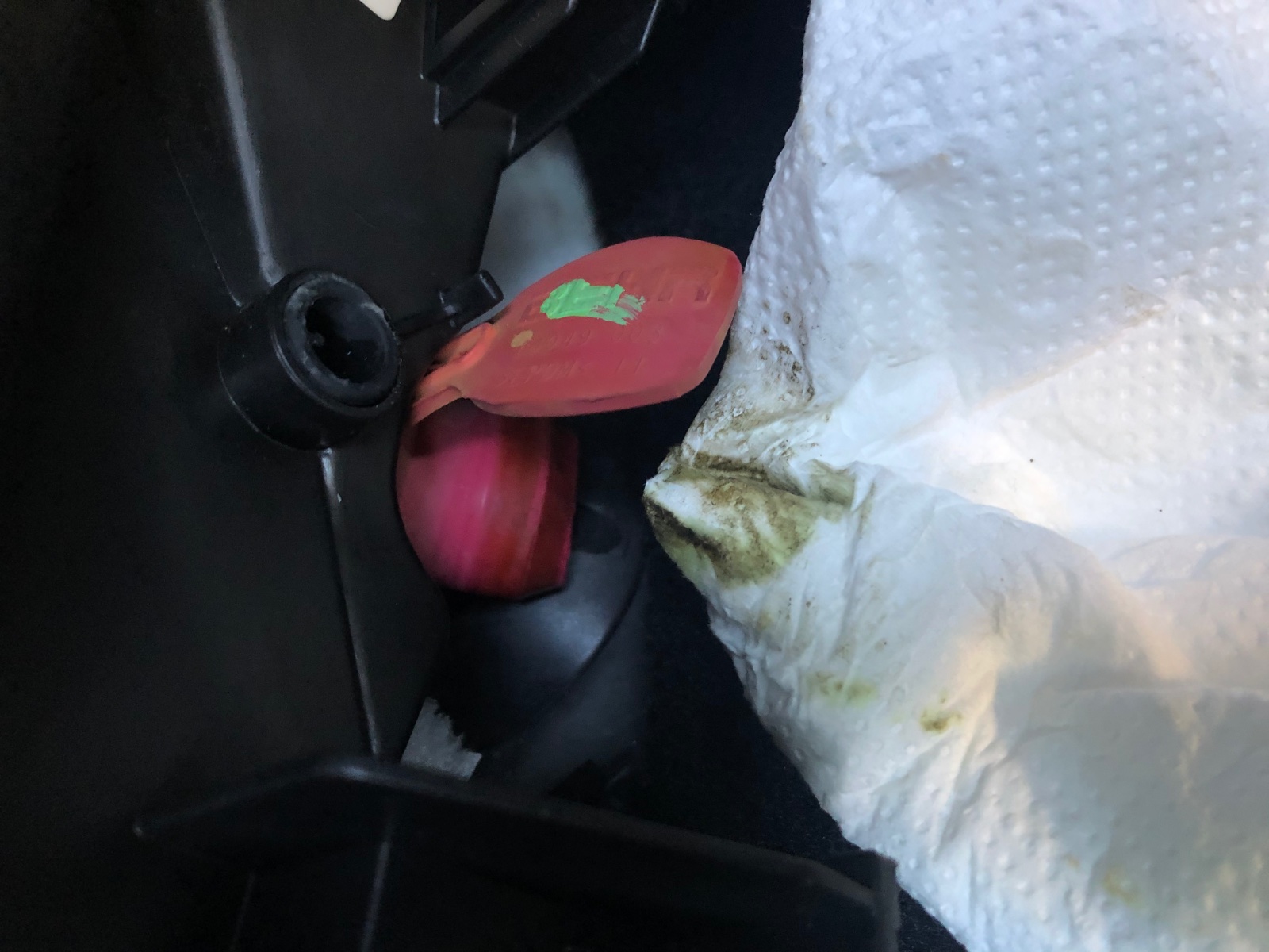

Unfortunately this is the leakage origin. I figured it out by finding contrast substance in the condensation pipe which is going out from the car (under it).

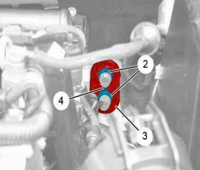

So as I mentioned in my email Vlad, if replacing the heater matrix, this can be done as follows:
DS3 1.4 Hdi Heater Matrix Remove & Replace
Tools
Removing
Engine compartment side
Disconnect the battery (follow the BSI Reset / Battery Disconnect / Reconnect Procedure)
Remove:
Left Hand Side:
Refitting
Refit:
Refit:
Remove the tools [4153-T].
Refit:
Fill and bleed the cooling system.
Check the sealing of the cooling system.
Refit:
Refit:
Tools
| Hose Clamps |
Remove:
- The battery cover
- The air intake duct at the air filter (DV engine)

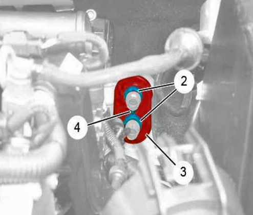

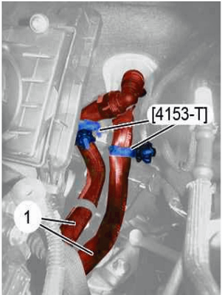

| Depressurise the cooling system. Position the tools [4153-T] on the hoses (1). Remove the locking clips. Disconnect the pipes (1). N.B.: Evacuate as much coolant as possible from the heater matrix using an air gun placed at the inlet. Position a receptacle to recover the coolant. | Remove:

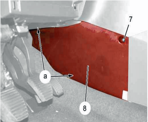

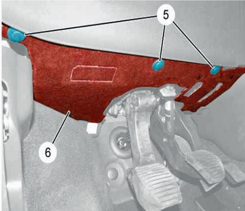

| Remove the pins (5). Release: The trim under the fascia (6). Disconnect the connector of the lamp (If necessary). Remove: The trim under the fascia (6). | Remove bolts (7). Unclip the trim (8) ( as "a"). |

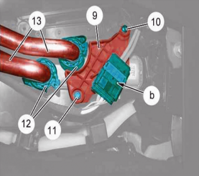

| Disconnect the connector ( as "b") (According to version). Remove:
Remove the heater matrix. |
Refit:
- The matrix
- The heater matrix pipes (13)
- The clips (12) (New)
- The heater matrix fixing panel (9)
- The bolts (10), (11)
Refit:
- The rubber seal (2)
- The retention panel (3)
- The (4) bolt
Refit:
- The air intake duct at the air filter (engine version DV)
- The intake resonator (engine version EP)
- The battery cover
Refit:
- The trim (8)
- The (7) bolt
Refit:
- The trim under the fascia (6)
- The pins (5)

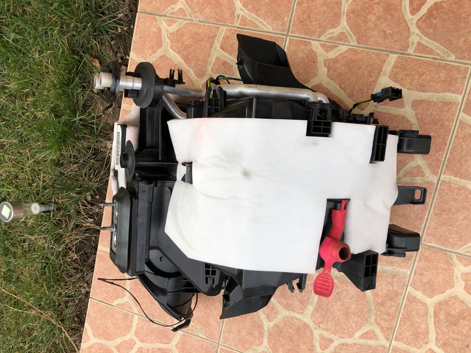

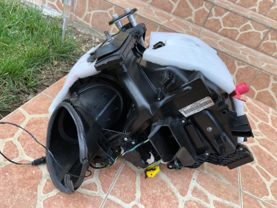

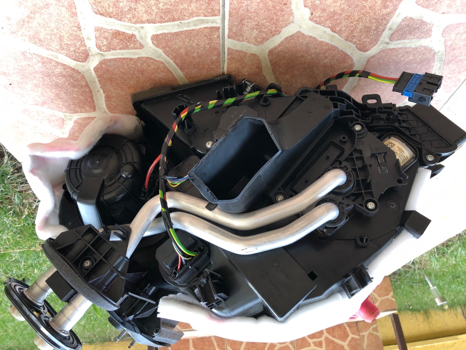

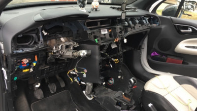

Re: Citroen DS3 A/C Evaporator leak

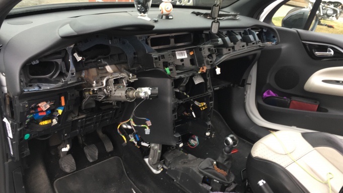

Good news, I have the module. I have assisted the guys to remove the dash and the module, for me it seems very complicated. After removing all the ornaments and displays, instrument clusters, central console, it was hard to remove the dash, being fixed on the reinforcement pipe with some screws mounted from the other side (from widescreen to rear side). So the guys has simply cut it. For sure I cannot do the same, therefore I would like to find out if I can remove the dash together with the reinforcement cylindrical pipe (same time). If not, it will become really hard.
For a better understanding after having the car like in the attached picture, it was almost impossible to pull the dash.
Hi! Unfortunately there are no bolts on the engine compartiment or under the windscreen. Only hidden screws are fitted into the reinforcement pipe but mounted somehow impossible to be accessed. From citroen documentation one step is missing unfortunately. These hidden screws are not shown. I am wondering if I can remove the steering wheel column directly from the bolt close to the pedals and pull the complete dash including the reinforcement.admiral51 wrote: 14 Mar 2020, 15:58 Hi Vladd
Good work on getting so far, however i think maybe Marc will be the one who may ( only may no promises) be able to provide you with a diagram of the locating bolts for the dash.
My guess is they will have nuts on that are located in the engine bay behind the sound proofing on the bulk head.
admiral51
- (Donor 2026)
- Posts: 2681
- Joined: 24 May 2007, 10:11
- x 391
Can you get some pics of the pipe and screws ?
100 eyes are better than 2
- x 6956
Vlad - 'reinforcement pipe' - do you have any pictures of this as I cant work out what you are referring to - if you can point out the location I might be able to determine if it is any other are apart from what I have sent you.
