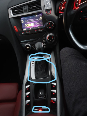

Hello, i have some chrome chipping off, as showing on he photo (not photo of my car), i need to take those parts out and fix it. How to take them out?

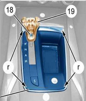

That part comes off with basic trim removal tools as shown.

Just make sure you use some blunt flat plastic tools to carefully prise the trim up and work aground gently, as these cost a fortune to replace.....
I just realised that this is not the exact part you circled, but the same applies - gently lift it up ar 'r':
