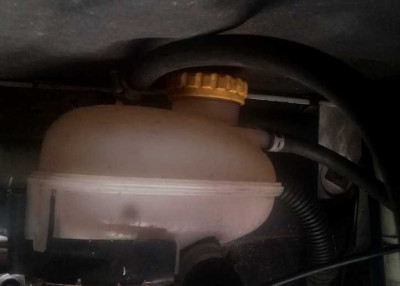

I was pleased to have got the height of the Reservoir 'bang on', crouching under the bonnet with it shut, there's about 10mm clearance between the Cap and the Sound Deadening.

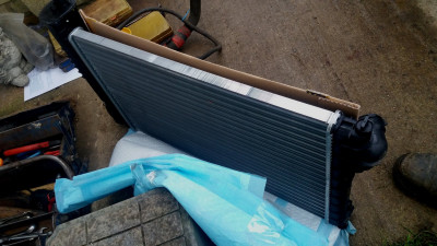

The fittings have been swapped from the old Rad to the new one: three different fittings were each a PITA in different ways, requiring a variety of methods of 'persuasion' to undo, even off the car. Not the greatest design.

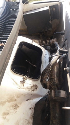

And as anticipated, some minor accident damage has been found beneath & behind the OS Headlight, that was easily fixed, but I've not yet loosened the fixings for the wing to see if it'll fit better; I'm feeling confident that it will tho'.

Anyone know what the Box on the NS Inner Wing is btw? I've not noticed it before.

I'm keen that my shiny new Rad stays shiny and un-damaged, especially in the course of fitting the replacement Lump, sometime soon
