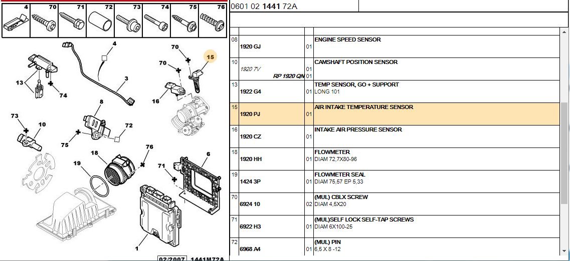

ENGINE DIESEL TURBO DW10BTED4 FAP
The intake air temperature sensor looks like its on the air doseur valve (Item 15)
But there is also another temp sensor (13) - not obvious where this is. Both are around £50 from Citroen - not really cheap enough to change on a whim... you really need some live data to see what the ECU can see which will help point at the right problem.

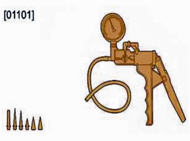

To check the circuit itself (whether the additive pump is being controlled or not):
You'll need a plug kit and a vacuum pump with the right adapters:

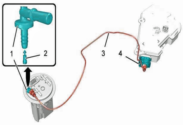

Manual vacuum pump DA16 with adaptorsPlug Kit
Fuel Additive Circuit
(1) Additive injector (Fuel pump gauge module ).
(2) Anti-return valve (According to equipment).
(3) Additive supply pipe.
(4) Additive pump (Additive tank).
Note: Some vehicles are not fitted with a non-return valve from the additive injector. The additive injector fitted with a non-return valve should open at a pressure lower than 400 mbars (According to equipment).

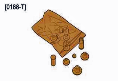

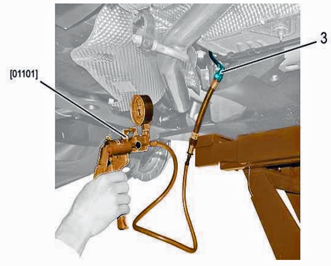

  • Plug the additive pump using tool the plug kit [0188-T].
  • Connect the tool [01101] to the additive supply pipe (3) (Additive tank end) using a click-on pipe that guarantees the assembly is leak free.
  • Activate, using pressure, the manual pump [01101].
CheckPressure lower than or equal to 400 mbarsPressure higher than 400 mbars
ObservationThe additive injector and the additive supply pipe are not blockedThe additive injector is jammed
