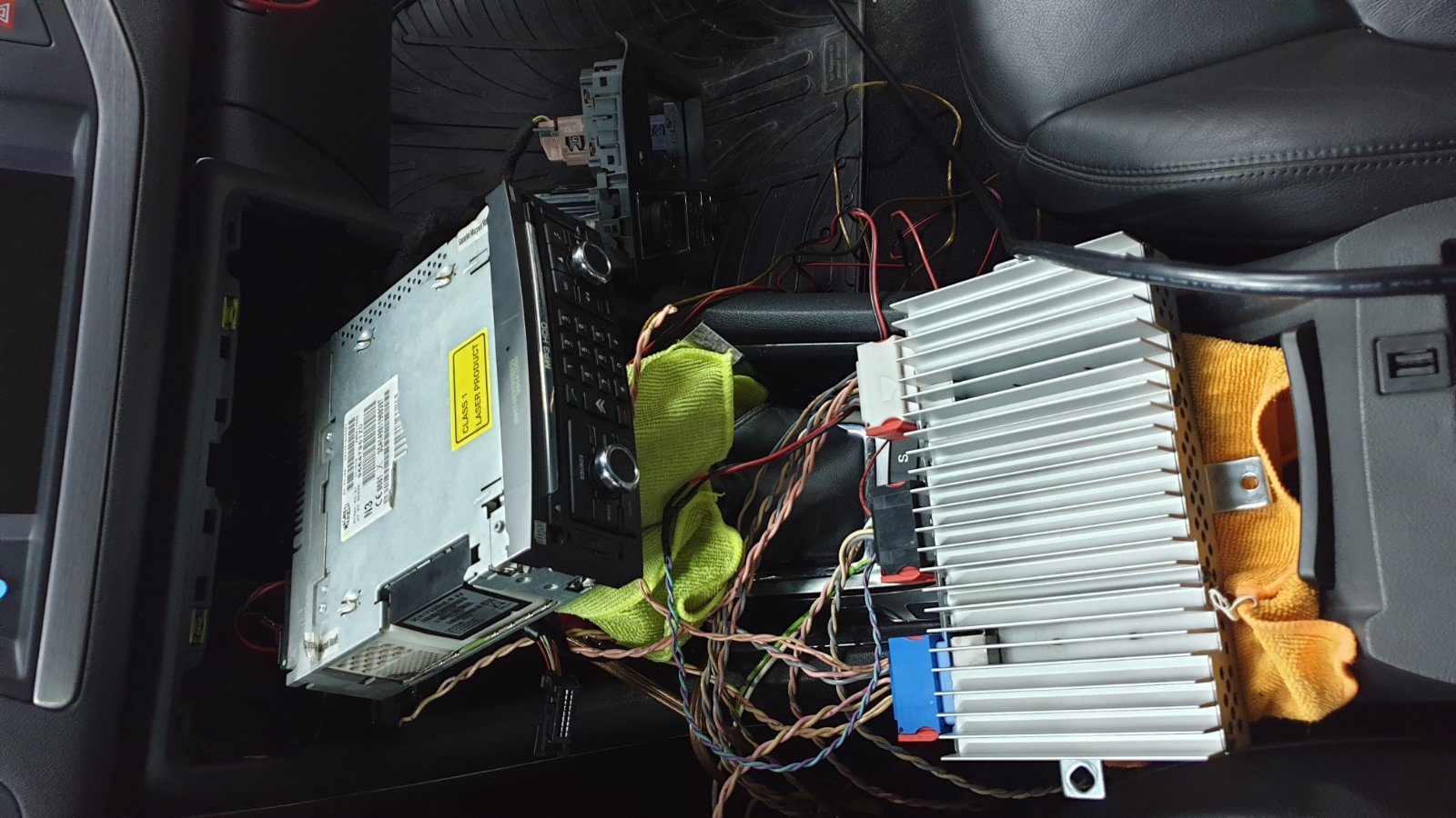

Hi again!
From a previous diagram of the amplifier connectors, for "connector A" there are 3 cables for the CAN comm as follows:
- Pin 2 - CAN+ (in my case, single red cable)
- Pin 7 - Comfort Can High (braided with the cable from pin 14, purple cable)
- Pin 14 - Comfort Can Low. (braided with the cable from pin 7, green cable)
As far as I know, CAN High is the same thing as CAN+, and basic CAN networking is CAN H and CAN L. Sometimes there is an optional CAN Ground.
Is there a possibility that "Pin 2 - CAN+", is not correct (on the diagram) and it is actually that optional CAN ground? It would be weird, as the color is red...
The RT 4 Fakra connector has 2 CAN cables, CAN H and CAN L, no CAN ground, or CAN+.
Thank you!

Fortius
- Posts: 26
- Joined: 23 Feb 2020, 21:54
- x 1
Re: C5 X7 RT4 - Fitting Factory Amplifier
OK, so I documented more and CAN+ is a new protocol. The audio signal is transmitted through this cable? Any idea where can I find a CAN+ cable on my harness?
OK, in that case, I have 3 CAN Cables on connector A... CAN H, CAN L and CAN+. CAN H is the same thing as CAN+?
- x 6962
Don't forget there is the CAN Comfort Network (High and Low) and then CAN CAR network and the CAN IS network coming into play. So Pin 2 (CAN High) & pin 14 (CAN LOW) are on connector A of the Amp, and on Pin 2 (wire Z91D) which the description is missing from my technical notes, but goes to the BSI and is probably a power / control wire for the amp.
Ok. I've connected CAN H and CAN L to the same wires at my RT4. I've used the Z91D wire for +12V and when I connect this cable i can hear a relay sound inside the amplifier (so this wire is the remote wire). I've used Diagbox and hifi amplifier was changed to present.
Still, no sound. I've used front left and right RT4 speaker outputs as front and left amplifier inputs and ...no sound. What next? Any ideas?
Fortius
- Posts: 26
- x 1
Hi!
I came back with details about the upgrade...
I've connected the CAN wires from the amplifier to the CAN wires from the RT4, the speaker output from the RT4 to the inputs of the amplifier, the amplifier speaker outputs to some speakers, I've modified the status of the amplifier to present using Diagbox but..no sound.
I have communication error between the BSI and the amp.
Tomorrow I will go to a local Citroen dealer to see if they can help me.
Will post an update and/or solution (if there is one) once I finish this project, one way or another...
