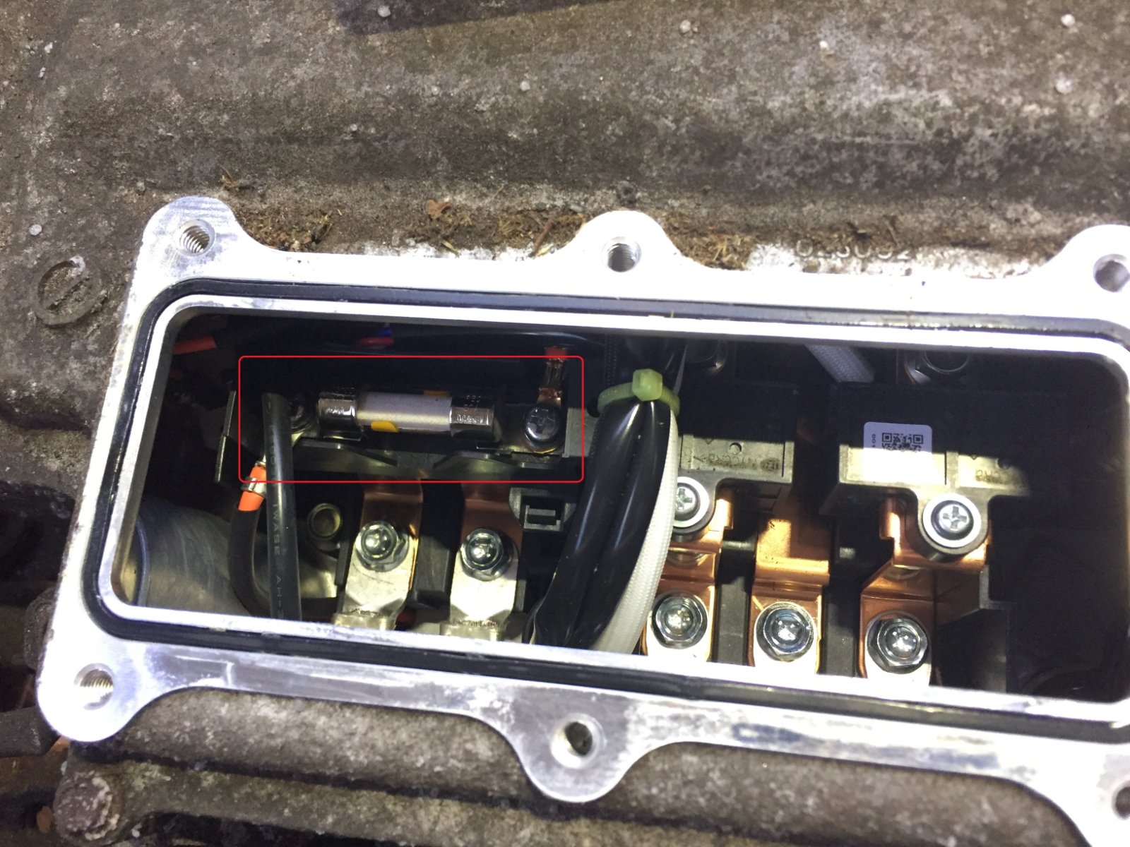

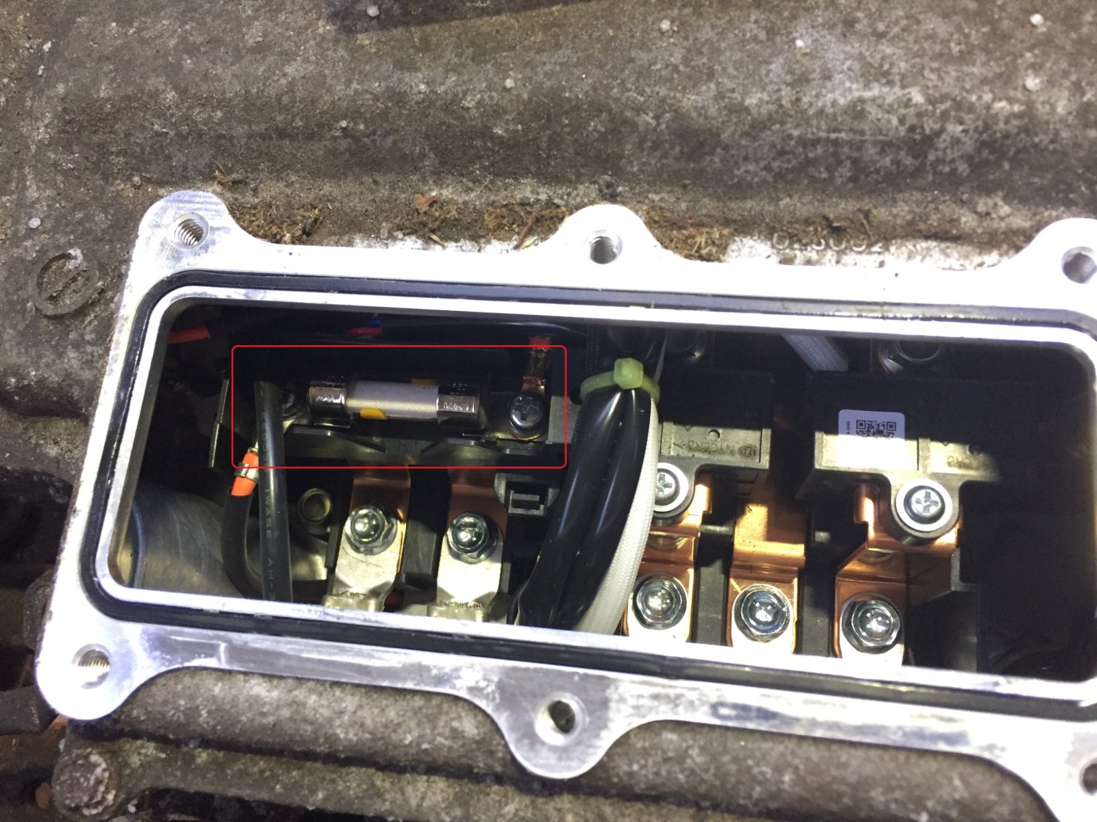

Unfortunately no, it's a special high voltage DC arc suppression type which is filled with something like sand:RichardW wrote: 26 Feb 2020, 11:38 That's a bloody expensive fuse - could you not have made something up to fit??
With high voltage high current DC if the fuse blows and an arc forms the air can sustain an arc that is longer than the entire length of the fuse body even from 360 volts...
Sure I could have put a piece of wire in place of the fuse as a stop gap and crossed my fingers - however if there is still another fault and I oversized that wire it could cause severe damage, and if I undersized it and it blew in normal use it would probably initiate the same over voltage and capacitor damage fault I've just repaired, since one of the theories is that it's the fuse that fails first from mechanical fatigue and then causes the other damage. Not worth the risk.
I actually ordered two fuses - I didn't want to wait another 10 days to get a second one if the first one blew because I'd missed something. Ironically that might have pushed it over £15 value.

Success!
The fuse arrived at work yesterday morning so I bailed and took a half day as the weather was "good" and following days were not! The ending was a bit anti-climatic, I fitted the new fuse, put the safety cover on, reconnected the safety link plug on the traction battery, reconnected the 12v battery, plugged it into the wall half expecting to hear a bang or pop but no, it just charged.
I also confirmed the 12v battery was reading 14.4 volts while charging as the fault had been preventing the 12v battery from charging as well.
I then just had to refit the passenger seat, motor housing cover and boot liner, reconnect the airbag and clear all the fault codes including the airbag fault I'd induced by having it unplugged and that was it, it's back on the road and charging and driving just fine, and I drove to work in it today.

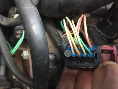

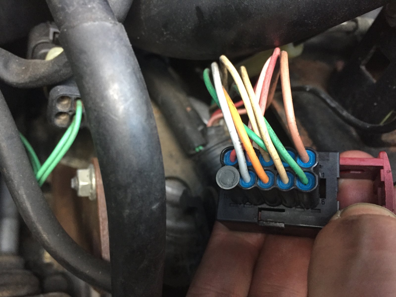

That didn't go quite as smoothly. I replaced the switch easily enough but it didn't fix the problem!!
However I've confirmed 98% that there is a broken connection between the switch connector and the gearbox ECU connector, and at least I know know for sure the fault isn't in the switch or the section of cable belonging to the switch. It's not a particularly long run of cable as the ECU lives under the battery tray right beside where the switch is.

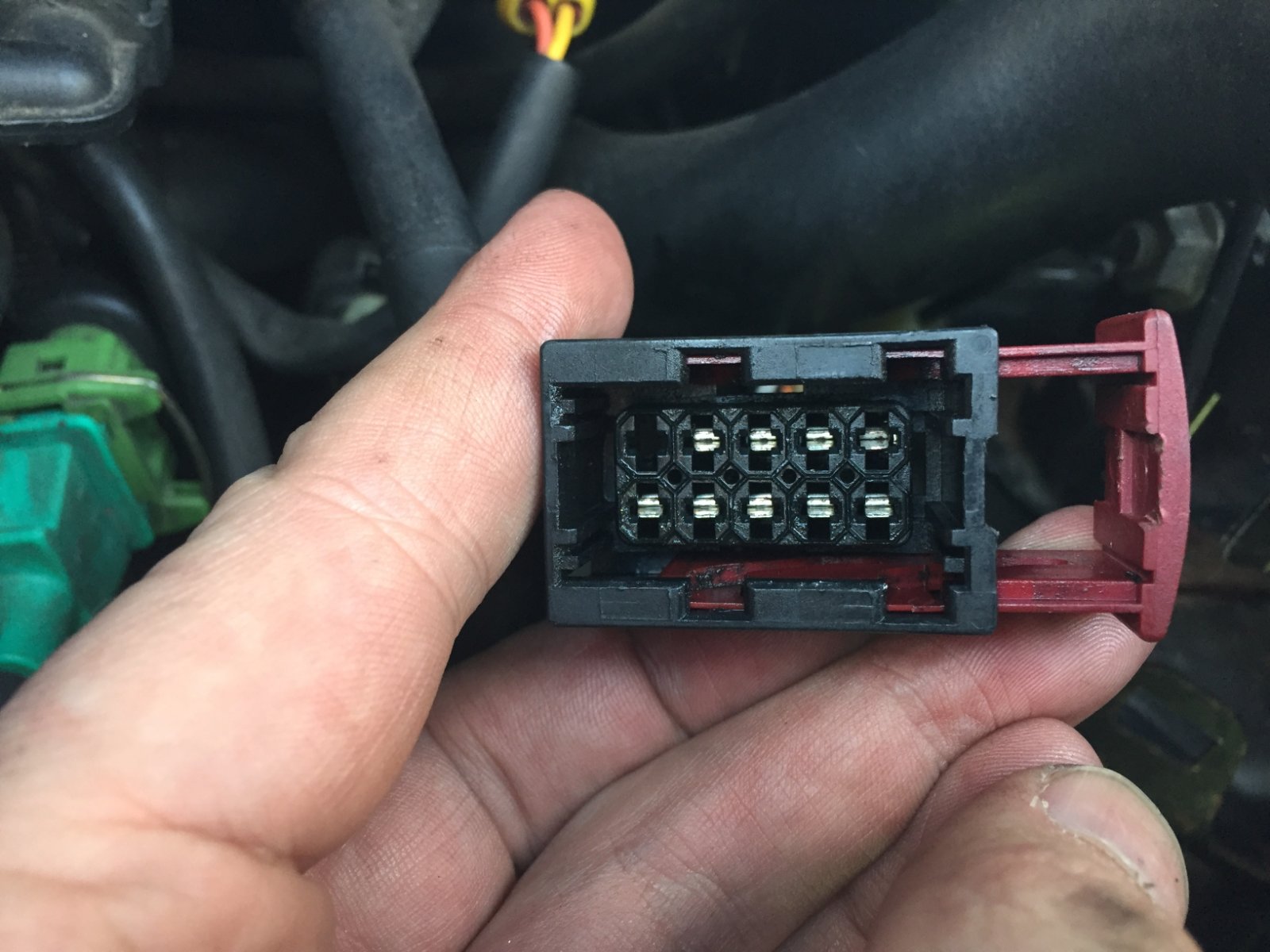

This is the plug, which is a kind that has rubber sealant where the wires go in:
So it's not something where you can re-solder the wire in the connector, nor can you easily poke a meter probe down to make contact with the wire. I've dealt with these kind of enclosed wires before though and you can "back probe" them using a regular household pin by pushing the pin carefully down right beside the wire until it reaches the bottom.

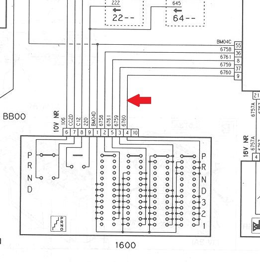

I've had a look at that part of the circuit and decided the break must be in the wire going to Pin 4:
All of the gears that work properly are those where the right hand switch contacts are open circuit - Park, Neutral, Drive and 1st gear. So if you move quickly between those particular positions it works 100% reliably. If you go to certain other positions however the gearbox ECU gets confused because the right switch being open circuit in some combinations of position of the other switches is an invalid combination - if you leave it sitting there more than a couple of seconds the gear position changes to a question mark and then refuses to work any further until power cycled.
By bending the wires in the vicinity I have been able to make it read Reverse sometimes so there is definitely a break, however the ECU reporting is too slow at updating to be of any use. So I think the only way to confirm 100% which wire is broken AND find exactly where along the wire it is broken is by lifting out the battery and gearbox ECU so I can do continuity checks from the ECU connector back to the switch connector. If I can find where it's broken I can replace that section of wire with another with solder and heatshrink joints. It's possible there may even be two intermittent wires.
A bit of a pain but I should be able to sort it. I don't think the connector itself is faulty, (and it has already had a good douse of contact cleaner) I think the break is a bit further upstream probably where the wires bend at a sharp angle a few inches beyond the connector.
