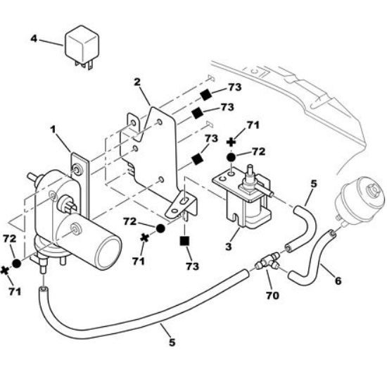

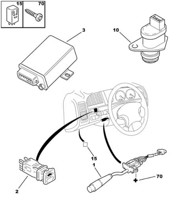

Hard to say, it's not shown under this model that I can see.
It needs the components above (on the right diagram) - but also the vacuum systems (the one shown for the XUD11BTE is on the left diagram) and I can't see any for theothers with cruise shown for this engine Alasdair - so I'm not sure. They have the cruise control and servo cable options listed for the ES9J4, XU10J2, XU10J4R, XU7JP4 witht he cable, but nothing I can see on an XUD11BTE engine that looks remotely the same (with servo cable).
