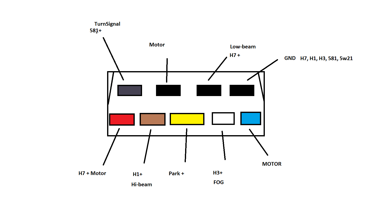

Its very hard to describe - i made front light diagram :roll:
I have GND, but i dont have activity in BLUE / Motor pin, it does not regulate front lights.. im out of ideas (PS! Lights are new [2 weeks old] also old lights didnt regulate, thats why i ordered new, i thought motor was broken and reflectors was anyway ruined(no rubber capsule behind lights).. thats one part of reason to buy new lights)

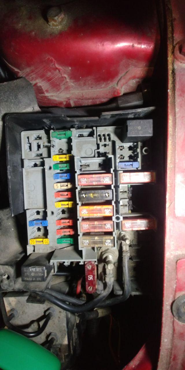

Thank you citroenguy those wiring diagram helped me to sort out fuseboxes, wires and i made my own Fusebox disgram (because not a single fusebox diagram what i found was 1:1 with my car)
If anyone need it, then link is here (its not finished, but maby it help someone
Those days was long and frustraiting, i had to pull Fuse 1 by 1 to sort out what any fuse does or not. Check (startpoint till end point measure with multimeter) all those wires to confirm i have connections as far as i need and to sort out those damn fuses (it was bit annoy back in my day to measure fuses every time when some stuff doesnt work), now i have "some sort of" diagram =P~

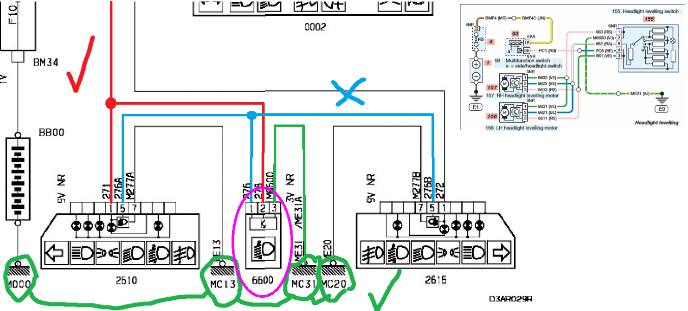

Problem nr3: "Front lights does not have regulate" Thats hard, maby i did ordered broken parts
I am that far, both (Original old and Ordered used parts) Front light leveling swiches seems to be broken somehow... or i broke them because of short?
I measured all connection from start to finish (from FLLS to Headlight) i have now all connections (as its have to be) [Maby BSI PFS1, Maby short in washer and ground fixed that?]! Lights still does not move
Spoiler: show
I have all wire connection as you see in picture, but i dont have still "Ohms/change/voltage/data" on colored blue wire from 6600 to 2610, 2615.

corresponding to diagram
6600 pins:
2 + (battery positive)
3 - (battery negative)
1 U (variable voltage)
I opened one oldest 6600 - all components inside seems to be fine (at least measured resistors inside was fine.. those "metal spring loaded" connection had seemed to be bit "soft" and maby didnt make any connection, fixed that and anyway now i have Ohms outputs!
Steps
3 - 0,72 kohm
2,5 - 0,90 kohm
2 - 1,08 kohm
1,5 - 1,26 kohm
1 - 1,44 kohm
0,5 - 1,63 kohm
0 - 1,81 kohm
Lets hope i see voltage drop in 2610, 2615 pin 9

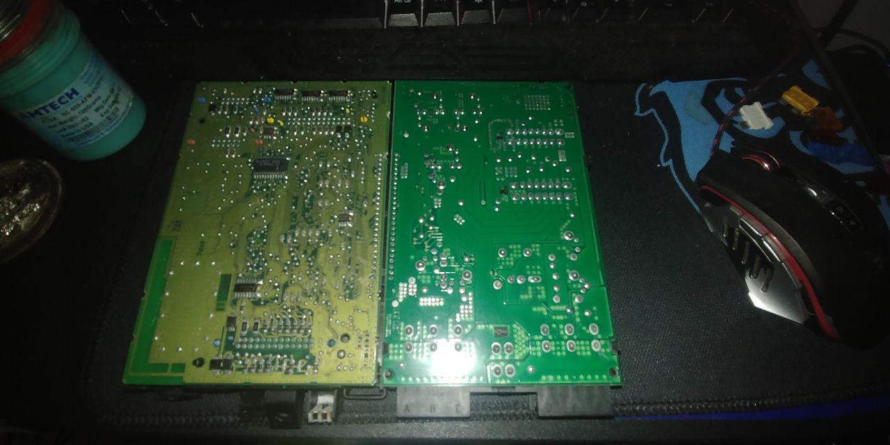

I also opened BSI/PFS1
Spoiler: show
Its bit in odd shape? :-D
Spoiler: show
  • I resoldered all pins/connections/components what you see in picture
    Measured thatmuch as possible and i didnt find any "broken" parts...
So it was somesort waste of time... but now i have one more unit removed "sort of" from my "broken component" list! :rofl2:

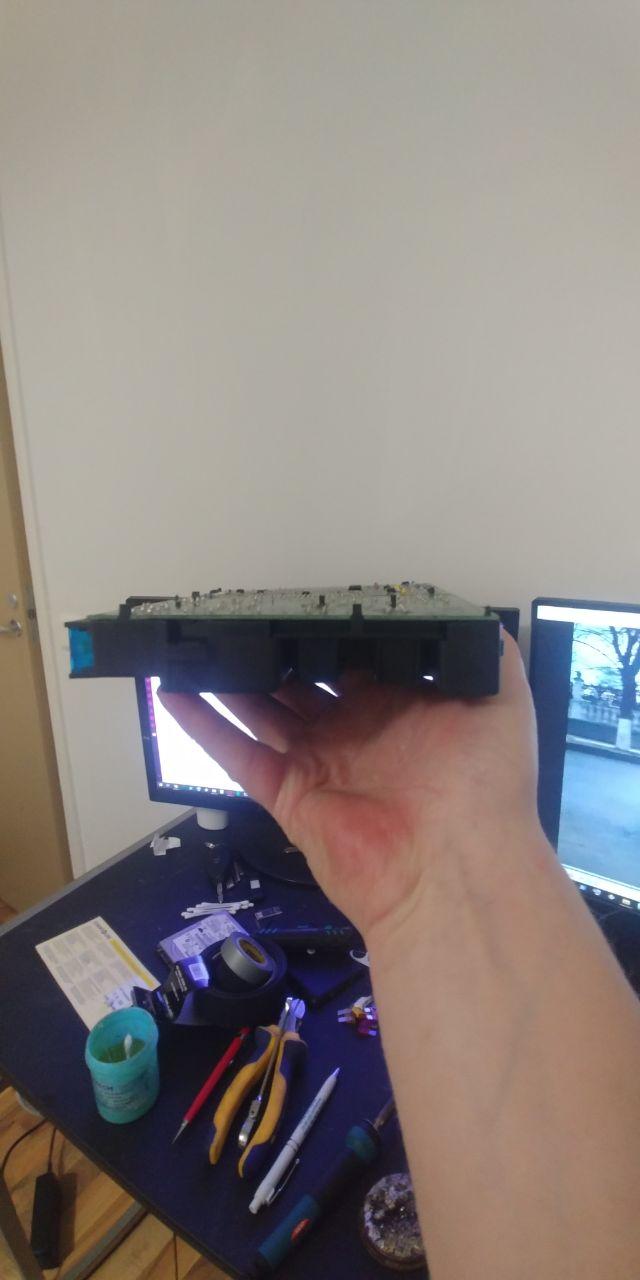

Picture:
All of this REF data is maching, all connector maching, but REF VALEO does not mach, i dont want to buy another part what does not have any use of my car and end-up in garage corner for collecting dust.. i have plenty of those parts allready...
Am i OK to buy one of these BSI and install it? or my car have some other problem what is not related with BSI? I know, i still hope BSI is fine untill i hear its dead atleast 3-4 people who know what they talk about
