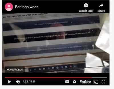

In your earlier videos, 2 possibles:
1. In the engine ECU you didn't get to the bottom of the list, it might be in here?
2. In the particle filter there is an option for 'programming of the total quantity of additive injected into the particulate emission filter' - you could try this and set it to zero (!)

I've just spent 45mins going through every option and I'm damned if I can find an option to replace the DPF or FAP.
The only option I can find allows me to program in the total quantity of additive passed through the filter.
I've set that to zero and it now shows zero when I look up the DPF parameters.
It's still showing the full mileage since fitting but the cinder count has gone down to 70 something percent.
It's still saying regen is blocked.
