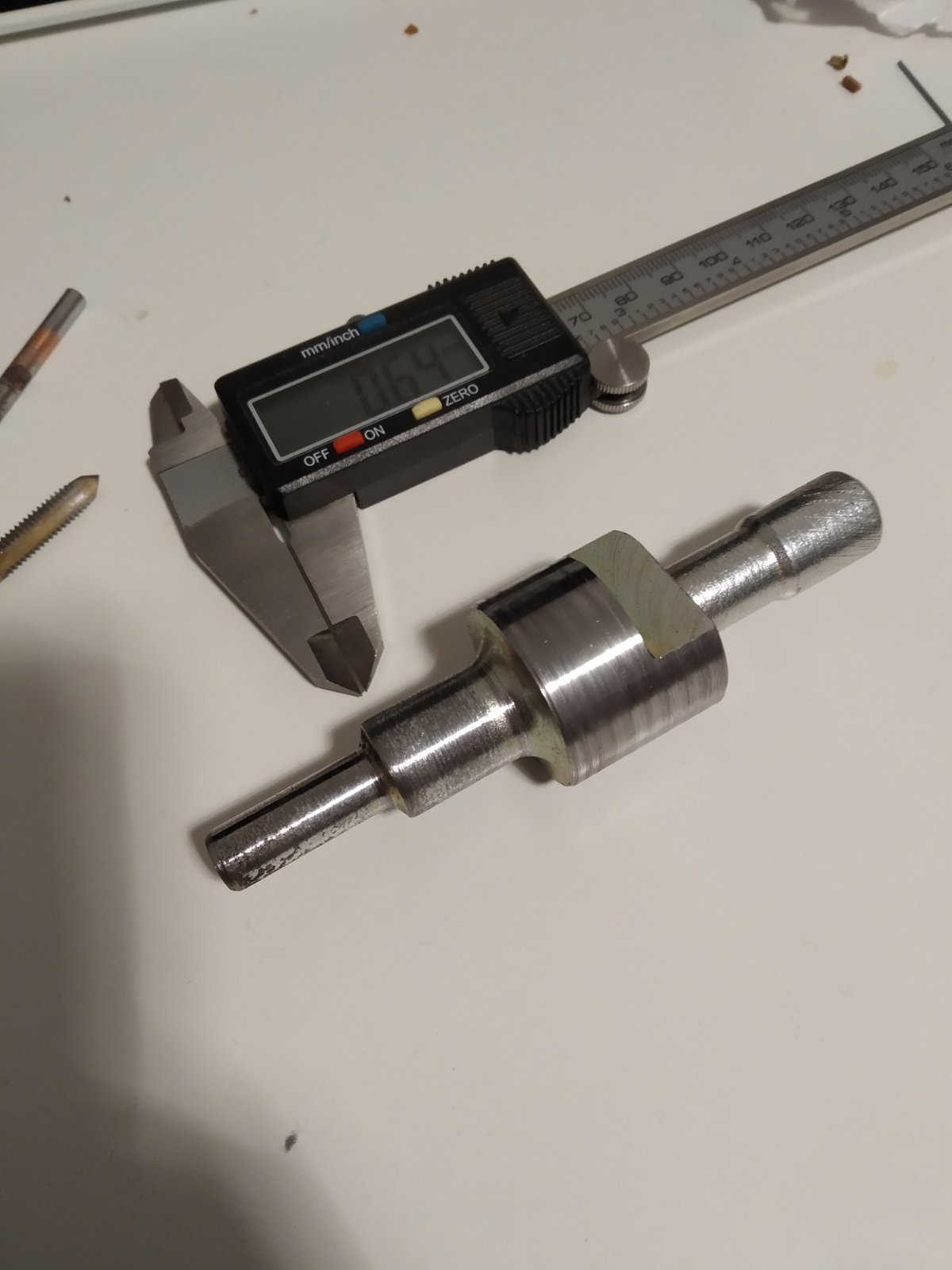

i can use only the flywheel pin, but i've just checked the measurements.. it's done over tolerance. instead of 29.5mm diameter is 30 , instead of 15mm is 15.1 and the small 9mm is 9.10mm
This is probably the reason that i can't push it in, i'll adjust it on my lathe.

Ooooooh yeah !!! i'm back from my workshop.
And now, after correcting the measures with the lathe, my flywheel pin fit like a glove !!
Also i've used 2x 5mm drill bits for the camshaft pulleys.
This UK machinist need some Swiss precision training :-D
