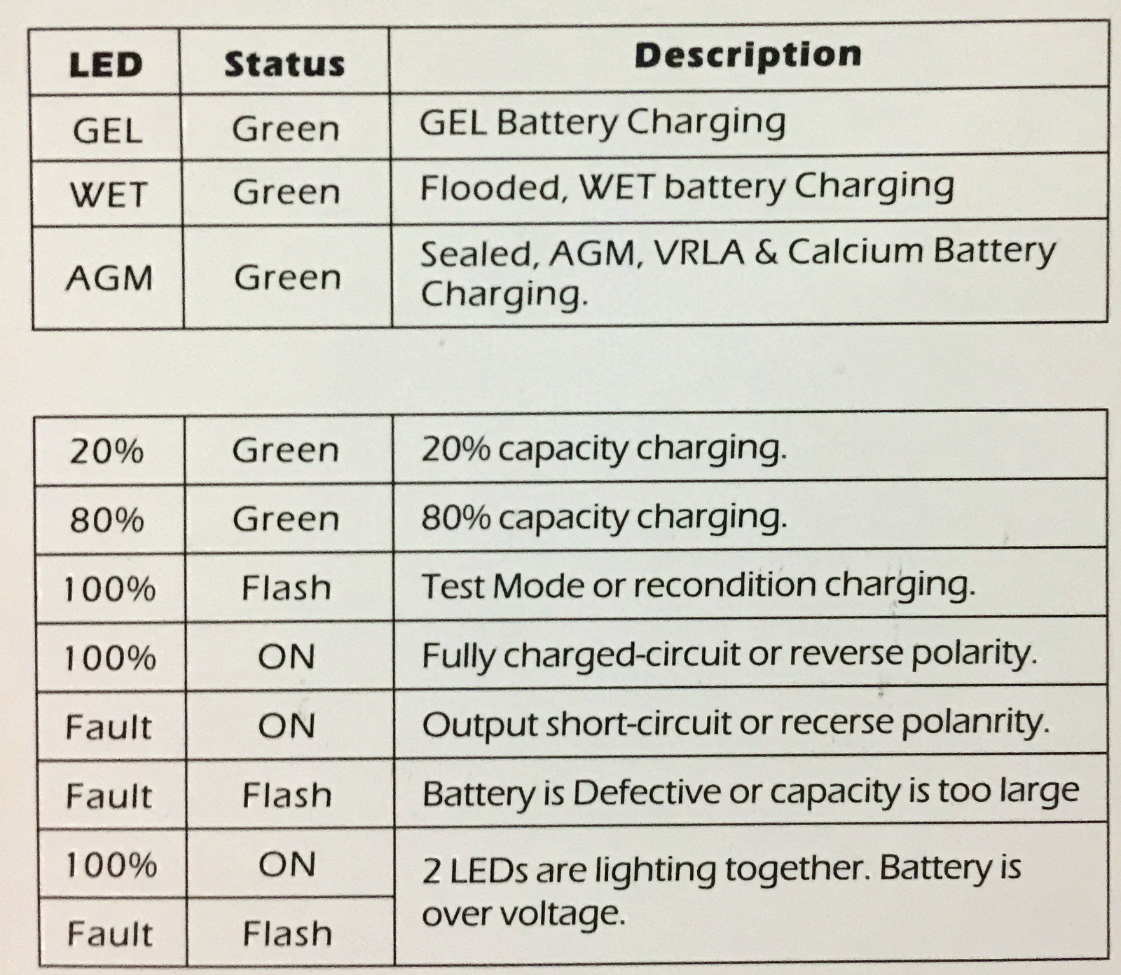

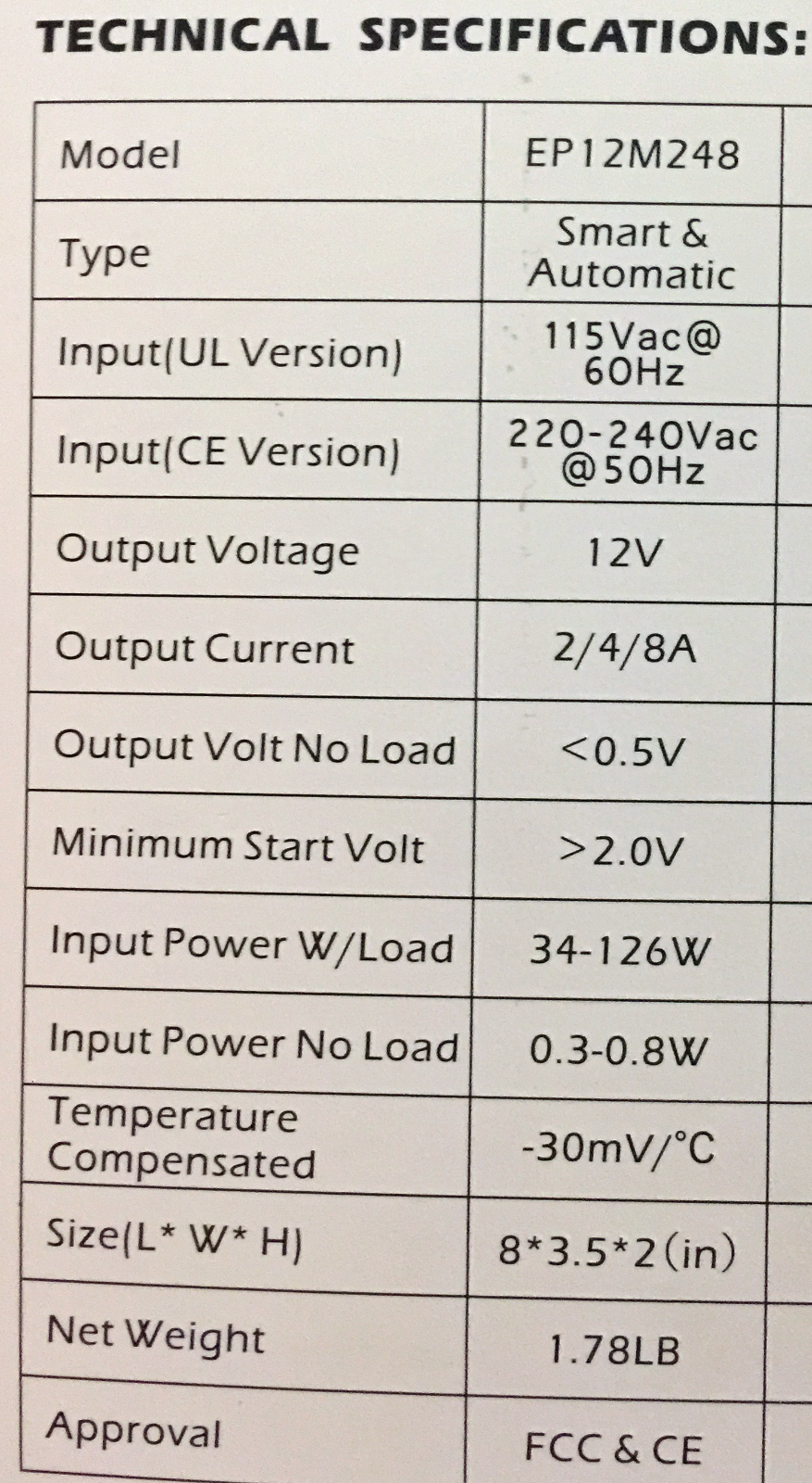

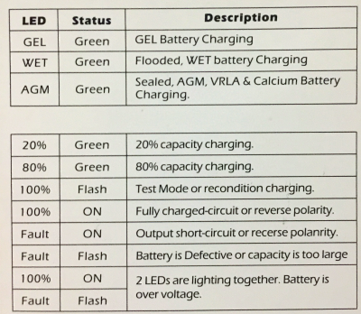

I invested in one of these, - just love the name
I just connect it up and it automatically detects my AGM battery. I leave it on the default 2A charge as I'm generally in no hurry, and therefore take it off the vehicle to do.

I think that covers it. It's the best one I've had after the useless 'advanced' charger I bought from a well-known UK motoring & bicycle outlet failed miserably with no warnings just out the warranty period - and that was over £50 back in the day, so wasn't cheap at the time.
