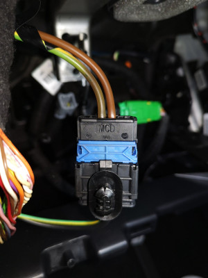

Day 2 of fault finding on the car, and I managed to catch the incoming voltage to the resistor pack drop to 8v, something it hadn't done the previous day. Tracing the live and earth back, they end up going to a plug by the main wiring loom to the left of the glove box (right hand drive).
The earth was discoloured from over heating and the pins were not creating a good contact inside the plug. Cut the earth from the plug and reconnected using a bullet connector, and the heaters have been working for nearly a week now

Hi Monkeyass,
I realise it is some time ago, but did you take a pic of your fix? Did you replace the existing plug or just use a bullet connector with the same plug? What size bullet connector?
Appreciate any additional info.
