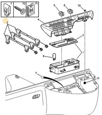

So you have cable controls for the distribution. Item 7 below still shows an A/C reduction motorised control. But the data isn't clear on the exact function this one unit performs. You have 3 cables shown on he first diagram but 4 sliders on the control panel IIRC...
<Corrected to Account for Single Air Conditioning System>
