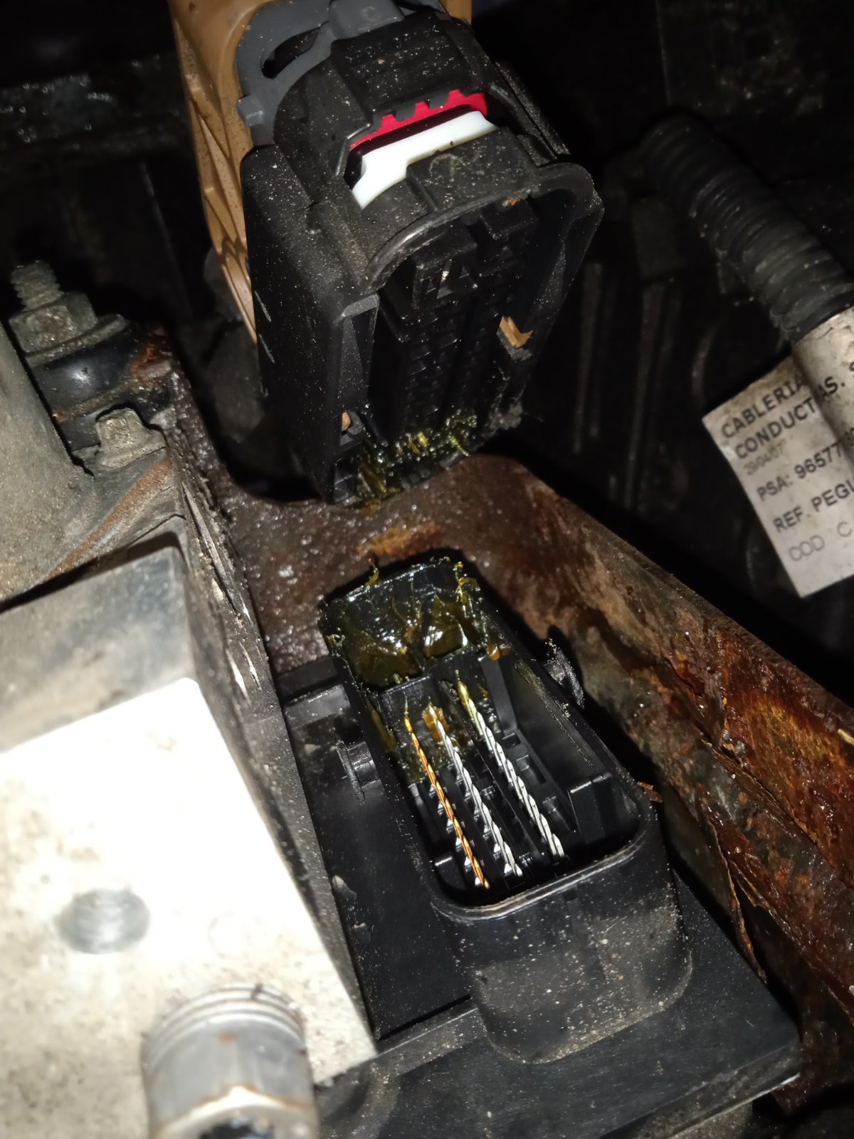

Hi,
Citroen C4 Picasso 1.6 HDi mcp 2007 VIN VF7**************[VIN obfuscated, can be read by forum staff]. The car was recently started on Wednesday, without any problems my wife went and came back from work. Today, after turning the key, a Christmas tree appeared with errors in the handbrake, ABS ESP, gearbox and Engine system management. The car starts, the engine works well, but there is no reaction to the gas pedal and it does not change position from N (it changes correctly only on the ignition). Handbrake works despite errors. After connecting to the diagbox, a few errors appeared (attached in the photos). There is no communication with the ABS ECU. I can't connect to it at all via diagbox, I'm getting a connection error message. What did I do while reading the forum posts:
- I checked the BF07 wire with the multimeter - there is a connection between the fuse (PFS1) and ESP (7800)
- I checked the CAN 9000 and 9001 cable between ESP 7800 and BSI1 - connected
- I also checked the CAN connection between ESP 7800 and 1320 ECU - connected.
What else should I check?
There is a lot of grease on the ECU ESP plug, is it normal? Should there be a connection between ESP pin 26 and BSI1 pin 4?

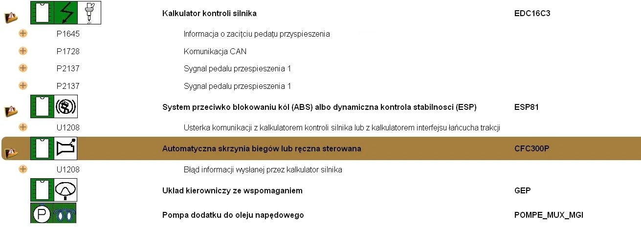

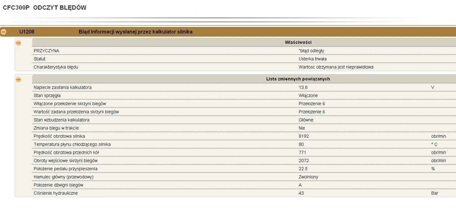

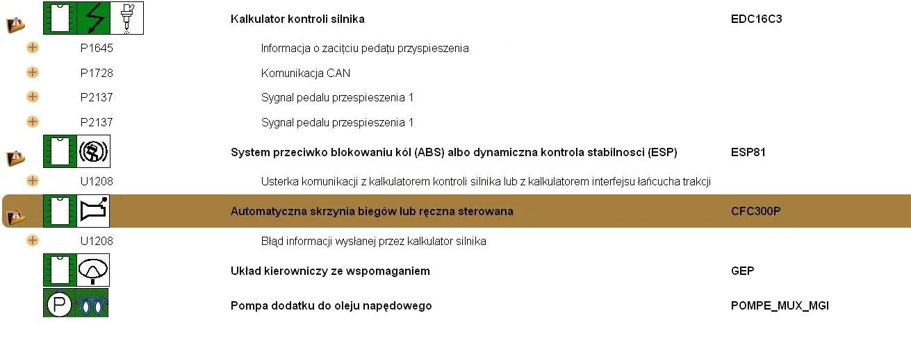

Re: Fault U1208
Here are the fault descriptors - have a careful read through. The first few relate to the accelerator pedal. These have 2 tracks of information inside the unit that are constantly compared with each other. When the data on one or more of the tacks in incoherent or does not make sense, then you'll get these faults. As this is linked to the engine ECU, of course you will be getting incorrect data so that can have a knock-on effect to the other systems.
So I would focus first on the accelerator as that can be the source of a lot of the issues.
| Fault Code: | P1645 |
| Description of Fault: | Accelerator pedal point of resistance information fault: Plausibility. |
| Conditions for Fault to clear: | Ignition on |
| Downgrade Modes whilst Fault is active: |
| Symptoms: | - |
| Suspect Areas: | Accelerator pedal |
| Fault Code: | P1728 |
| Description of Fault: | CAN communication: Lack of coherence of the engine torque information sent on the CAN. Engine torque information sent on the CAN not coherent. |
| Symptoms: | Lack of power |
| Fault Code: | P2137 |
| Description of Fault: | Accelerator pedal signal: Coherence between the 2 tracks of the accelerator pedal sensor. The difference between the accelerator pedal sensor track 1 and track 2 signals is greater than 6 % for 200 ms. |
| Conditions for Fault to clear: | Driving for 5 minutes with frequent pressing of the accelerator pedal. |
| Suspect Areas: |
| Fault Code: | U1208 |
| Description of Fault: | Fault in the information transmitted by the engine management ECU: Value received incorrect. No information sent by the engine ECU (Foot throttle pedal; Engine speed; engine torque). The time of appearance of the fault code is 1s. The following conditions have to be met for fault activation: - Ignition on - The starter motor is not operating |
| Technical precision on the context of appearance of the fault code |
"SERVICE" warning lamp Sport warning lamp Snow warning lamp Automatic or 6-speed piloted manual gearbox warning lamps (Orange PRND triangle) Display of a "-" on the fascia panel |
| Conditions for Fault to clear: | Reception of 20 consecutive items of valid information. |
| Downgrade Modes whilst Fault is active: | Possibility 1 Engine speed fault - Change to neutral and no gear can be engaged - Opening of the clutch when close to idling speed - Take-off deactivated (With the vehicle stopped) - If the vehicle has the Stop and Start system : Stop and start function deactivated Possibility 2 Accelerator pedal position fault - Automatic mode deactivated - Change to neutral and no gear can be engaged - Opening of the clutch when close to idling speed - Take-off deactivated (With the vehicle stopped) Possibility 3 Fault with engine temperature and torques - Gear engagement downgraded - Crawling deactivated |
| Symptoms: | Possibility 1 Engine speed fault - Automatic mode deactivated - Change to neutral and no gear can be engaged - Take-off deactivated - Difficult/impossible to change a gear Possibility 2 Accelerator pedal position fault - Automatic mode deactivated - Change to neutral and no gear can be engaged - Take-off deactivated - Difficult/impossible to change a gear Possibility 3 Fault with engine temperature and torques - No customer complaint |
| Suspect Areas: |

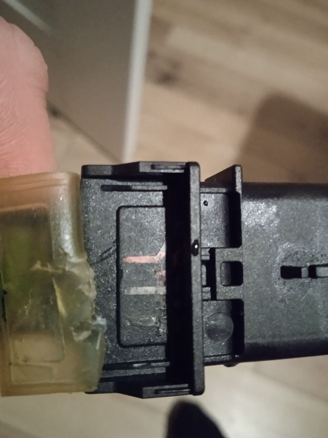

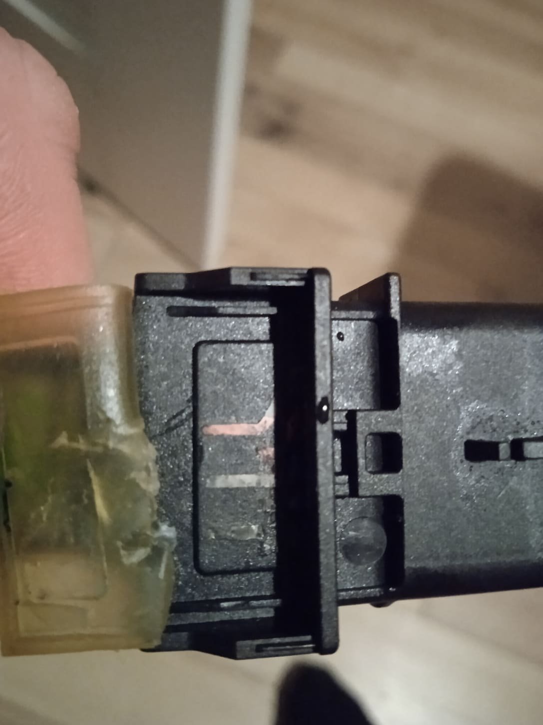

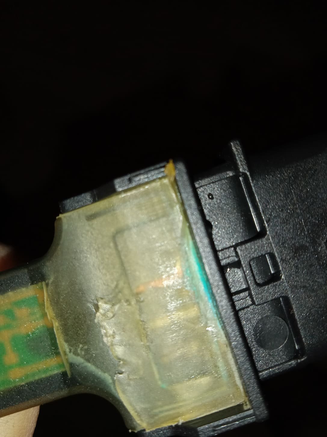

Re: Fault U1208
Bingo!
I checked the accelerator pedal potentiometer and noticed signs of corrosion on the silicone cover. There was a problem with water dripping down the cable. Everything seems to be secured, but probably a hole appeared over time. There wasn't much water. Literally single drops. Water also appears on the other side - on the battery and fuse box. The cause is probably blocked drains. Thank you very much for help!
