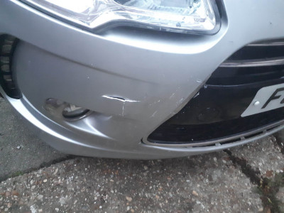

Thanks for your reply. The vehicle damage was front bumper damage and bonnet realignment, nothing major. The headlights were replaced and new air con condenser. The insurance deemed it cat n write off but I had only purchased previous year at a lot higher price than they valued it at so I had the repairs done by my local garage who deals with all my repairs. It's at the garage today and they are trying a temperature sensor. Other than that no codes have come up. Just really wanted advice 're screen as this was never touched by my mechanic.
