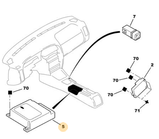

I'm sure I don't need to advise you about disconnection of the battery and waiting for 10 minutes or so before touching the airbag components, but the airbag ECU is in the centre console item 5, but all connectors must be detached if you are considering (and before) removing it:

Ahh lovely thanks (yes don’t fancy airbag going off!). Is there a rotary ring in the steering wheel?

The airbag for the driver is in the main boss (2), but there is no rotary dial on these - the remote audio controls are supplied by a separate harness, and you don't ESP, so no steering wheel angle sensor.

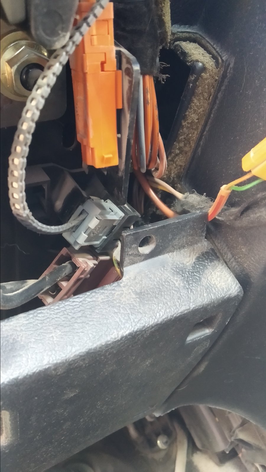

Anyone there? Can't get the wire connectors off!
The blue grey one in the pic. Plus how does the orange one come off the support?
Ta. I'm fed up off being upside down and my back hurts!
