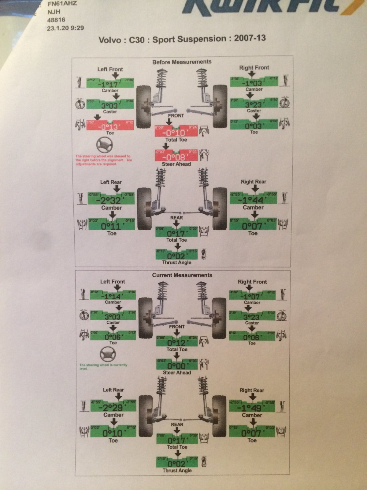

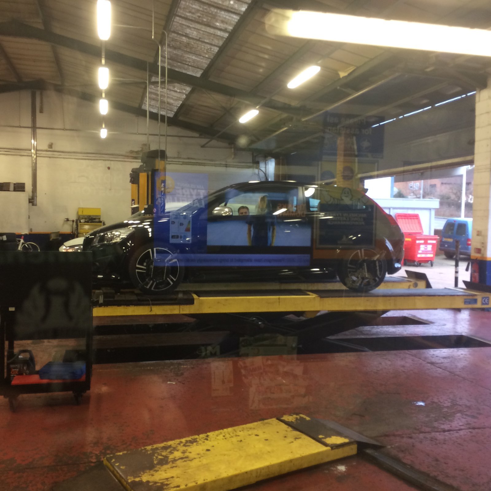

The reason I pointed out the Kwik Fit alignment check is I took my C30 for one last week as the only place near that did the laser 4 wheel thing. The amazing thing was they were really good! They stick the car on the ramp and clamp a gizmo to each wheel then the setup is shown on the screen in the waiting room and they ask what you would like to do. I had the tracking done for about £50 but I could see for myself what all the toe in and out and camber was for all 4 wheels. Also I was impressed with how they dealt with all the customers there including your generic old lady in a Jazz who was worried the tyres were worn out, they reassured her they were fine and put the correct pressure in them told her come back in six months, no charge! Also a bloke with mobility car they went out of their way to make sure he had a good experience and got what he wanted. Maybe it's just my local branch, but I would say they were really great and I'll go back there. Not what I'd had in the past and not what I expected.
C30 T5 on ramp
Read out printed off for me
