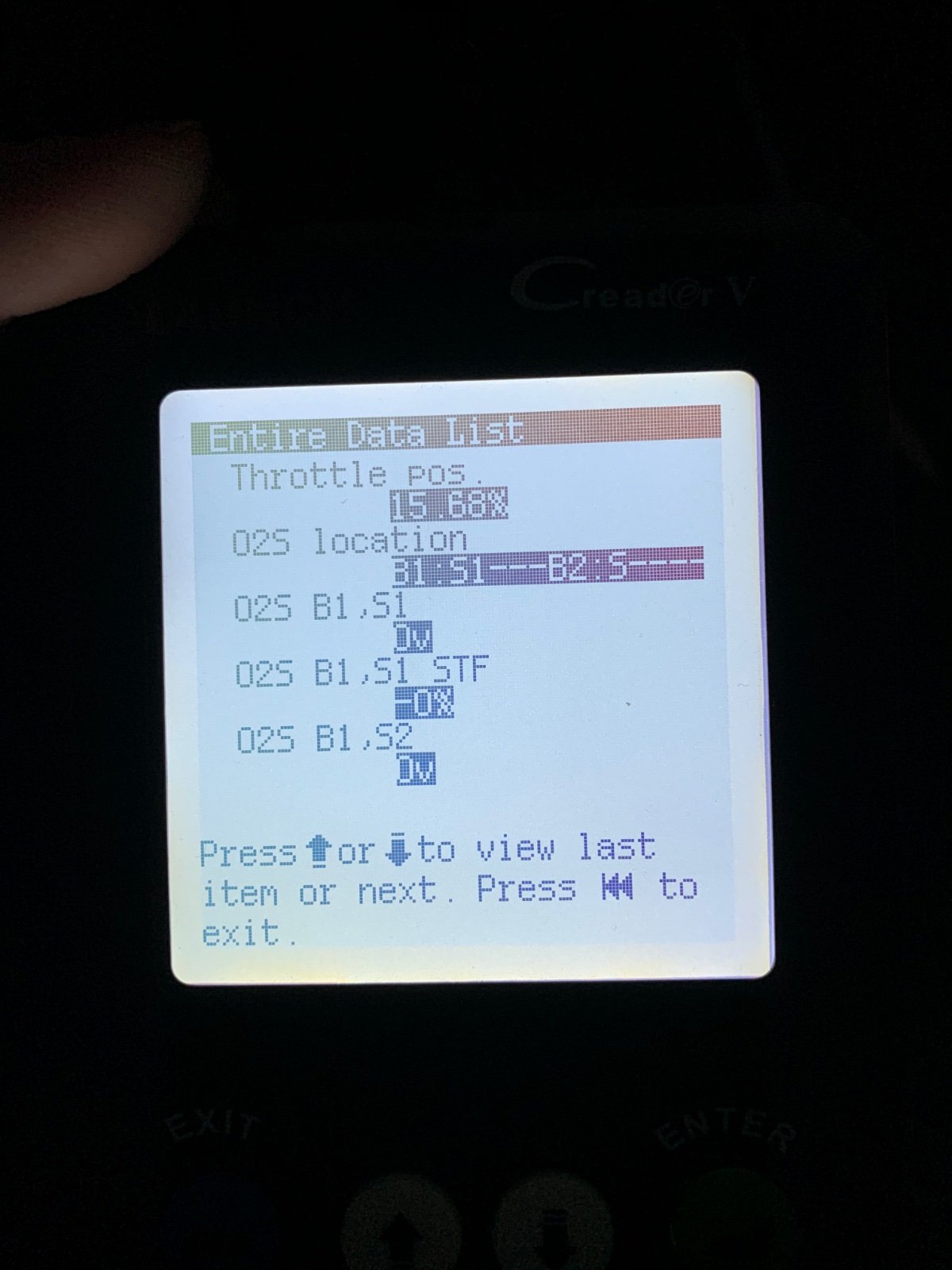

Hi there ! I’m new here so expect many dumb questions:-)
Today I was playing with a cheap odb2 scanner, just to read some values and try to understand the meanings.
One thing took my curiosity : the Throttle position % was at near 15% even with the engine off and the pedal not pressed. If I press the pedal completely I read 80%
Is this normal ? Shouldn’t be likely 0% to 90%at least ?

Pretty normal from my experience (206 GTi180 and 1.4i Verve on Launch handheld scanner) Both of those seem to sit around 12-16% engine off or idling, 87% if I bury the pedal in the carpet... I don't fully understand why, but I imagine it's more to do with the ECU's capacity to open/close the throttle further if it needed to (for example if it was tight toward the end of it's travel) & probably based on the current rating or % of PWM modulation of it's driver circuit.

Because these 'drive by wire' systems no longer have a cable connection to the motorised throttle housing, they use an analogue potentiometer in the accelerator pedal mechanism to send data to the engine ECU and this commands the butterfly housing motor to open close.
These use varying electrical voltages (OCR) on the 2 tracks:
Throttle open:
Voltage between Earth & Track 2: 0.5V
Voltage between Earth & Track 6: 4.5V
Throttle Closed:
Voltage between Earth & Track 2: 4.5V
Voltage between Earth & Track 6: 0.5V
But in order to be able to detect short circuits to Earth, the range of 0V to 0.5V is used and to detect short circuits to positive, the range 4.5V to 5V is used. So that's why the values are not absolutes and looking at the percentages.

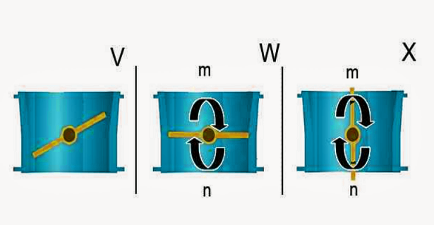

Motorised Butterfly
V: Position of the butterfly at rest (ignition off) or "limp home" position in the event of a failure.
W: Position of the gas butterfly with the ignition on or at idle.
X: Position of the butterfly at full load.
"m": Force of the butterfly motor.
"n": Force of the spring.
With the ignition off, the "limp home" spring holds the butterfly open (phase V).
When the ignition is switched on, the injection ECU controls the butterfly to the idle position, countering the force of the "limp home" spring (phase W).
Engine idling; the gas butterfly moves so as to supply the necessary air flow to the engine (replaces the idling regulator stepper motor).
From 1500 rpm the injection ECU controls the gas butterfly in the other direction to assist the "limp home" spring (phase X).
The position of the throttle is monitored by the injection ECU (potentiometer incorporated in the butterfly unit).
The injection ECU cuts off the supply to the throttle housing if certain faults are present.
