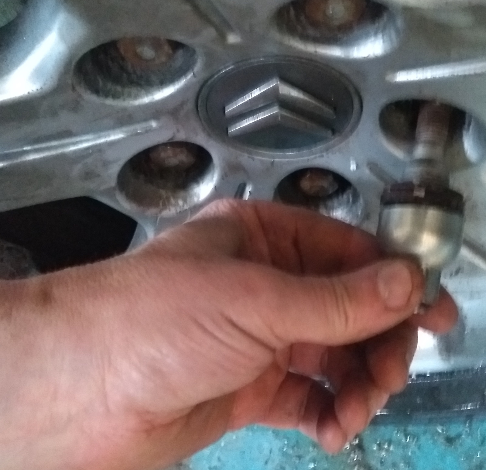

9 am sharp into the garage; first I tried to grind down the wheel bolt removal tool (here on in known as the tool) the idea simply to grind off the mashed up tool protrusions and expose good clean contact. This was quick to do and as quick to fail…. What next was several brews and lots of head scratching when I had a Eureka moment. “Bolt the tool to the wheel bolt”

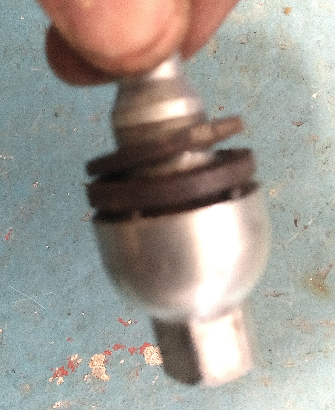

Using a small Piller drill, pilot drill the Tool. Finding centre was easy due original manufacturing marks. you can see in this picture the lugs 4 off that protrude and are supposed to catch in the wheel bolt with opposing grooves. the thing is as you see in later photo is the point of contact is very shallow.
After the first hole drilled,

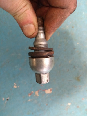

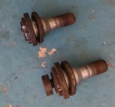

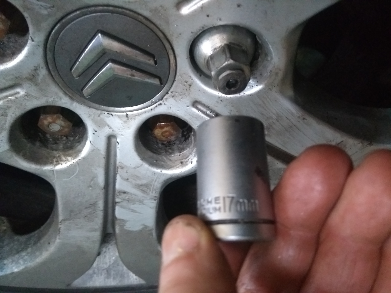

fullsizeoutput_5c.jpeg[/attachment) Drilling this hole i used the Tool as a guide for concentricity. So now i had a 3mm pilot hole in the wheel bolt and the Tool. The bolt now passes through the tool as i allow some clearance for the 8mm bolt You can see the difference as the spigot on the end of the original bolt has been drilled off. Now i continued drilling the car's wheel bolt to 7mm diameter for tapping with 8mm tap for the 8 mm bolt. Now with the wheel bolt on the car drilled and tapped and the clearance hole drilled in the Tool. I test fitted them. All was fine the 8mm bolt now clamped the Tool securely to the car wheel bolt. So came another test fitting the 17mm socket i tried to undo the wheel bolt, but alas it slipped again, looks like a combination of the Tool being worn and the bolt i had not tightened up enough. Doh only one thing left to do. Yes, repair the Tool. I drilled out all of the 4mm lugs with a 3.8mm drill and cut up a 4mm drill shank and pressed them in using a vice. so now i have a Tool with 4 new lugs. Hay presto success . It might be 5pm now and a day wasted thanks to pissant but i managed to get all of my other wheel bolts out and present them to the bin eBay suppling the replacements, 4 bolts in each wheel will do for the time being.. Sorry all photos out of sync, i get sick them keep moving during draft . [attachment=0]fullsizeoutput_4a.jpeg
showing pilot hole
showing pilot hole
Pilot hole drilled in to wheel bolt
