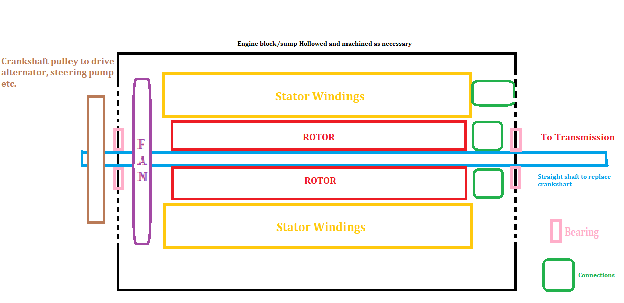

Schematic illustration of my idea to convert the engine to ac motor thereby allowing me to keep engine mountings, transmission linkage and all aux systems as standard. I could therefore source a wrecked engine and build the new one before touching the car. Then when completed it could be swapped out. This concept would also allow the reinstatement of the original engine should the need arise.
Own work and design
Own work and design

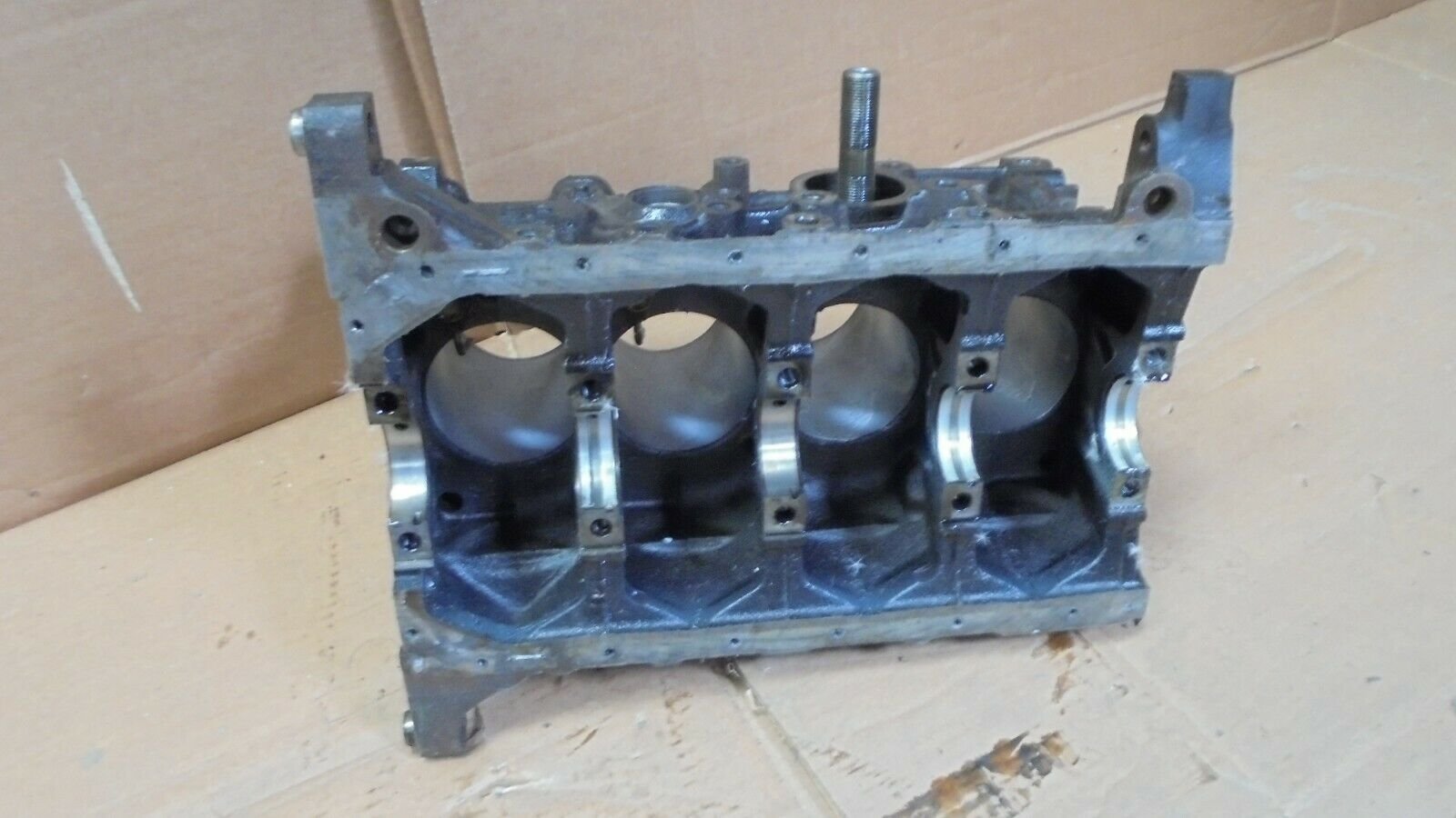

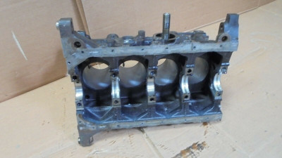

This is similar to the block that will need modifying, machine out main bearing cases 2 & 4 and fit twin rotors while keeping the centre bearing might be the way forward. I need to do the sums to see if sufficient power can be produced from the stator and rotor sizes I will be limited to! :)
Borrowed from ebay
Borrowed from ebay
Borrowed from ebay
Borrowed from ebay

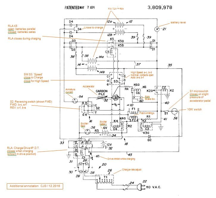

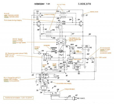

For real shed stuff, try this...
...described here
https://patents.google.com/patent/US3809978A/en
