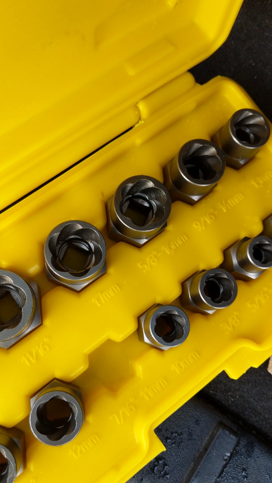

akube
- Posts: 7
- Joined: 22 Jan 2020, 20:30
- x 1
Re: Rounded Injector Bolt, 1.6 HDi
Hello everyone, I have an update!
I managed to get it out using a reverse threaded socket! I am so happy right now
