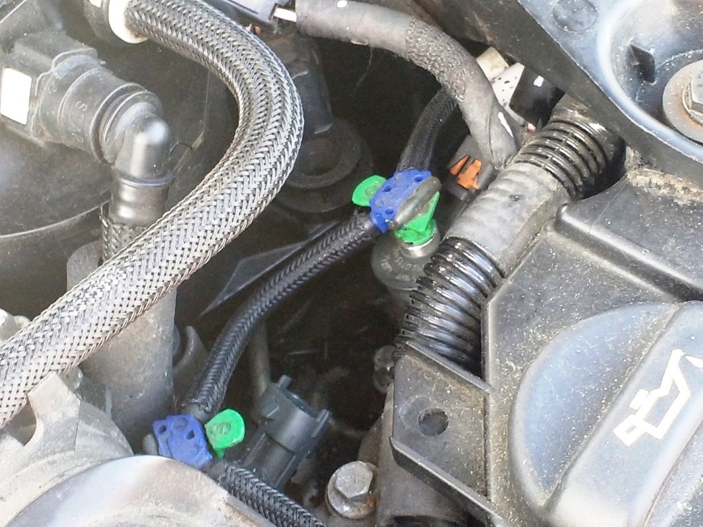

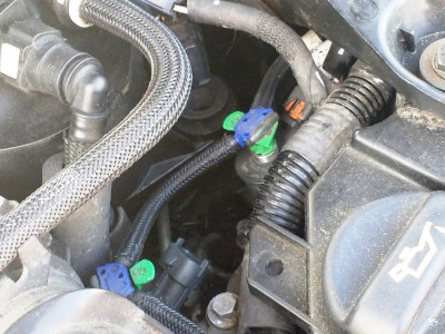

Lordy, what a battle this is. First a photograph.
I had a look at the engine on Sunday and I couldn't figure out how to get the leak-off connector off the injector. I searched for the same type of connector and eventually found a YouTube video of someone changing "green tabbed" leak-off pipes. From this I worked out that the green wings have to be pulled upwards to release the connector. If you look closely at the photo you can see that there's a ridge of adhesive on the connector tab to stop this from happening.
So, today I set to work to gently chisel away at the adhesive, hopefully without breaking anything. Surprisingly I managed it although it did take about an hour in total. After warming the engine I pulled the tabs up and pulled the connectors out. I found that loosening off the air filter housing and pushing it slightly backwards helped with access. The YouTube video confirmed that No 1 cylinder is at the gearbox end and that the cylinders are numbered 1,2,3,4.

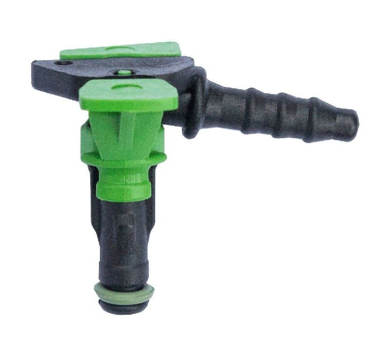

And then another juddering halt. The test kit didn't have adaptors small enough to fit the injectors! Looking at similar kits on Ebay none of them have suitable adaptors, Here's a photo (taken from Ebay) of this green tab connector.
So, tomorrow try some other avenues.

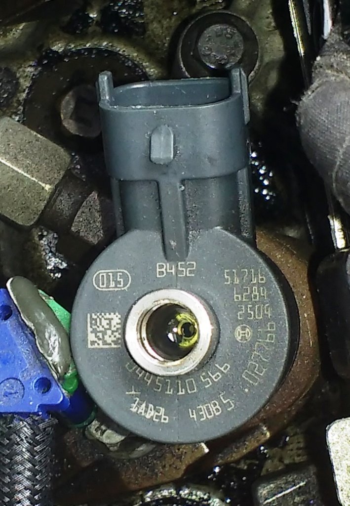

I believe that the replacement injector needs to have a code put in to the ECU. This is the current No2 injector. Which of the figures is the code?

Is it just me or does it look wet at the base of that injector?

Yes it is wet and I think it's engine oil. Visible all the way along the back edge when I pushed the air filter to one side. I soaked up a lot of it with paper towels and am just waiting to see if it comes back - although it's not being driven a huge amount at the moment and may not be getting the miles it needs to show up.
I wondered whether the oil had come from a sloppy fill-up at an oil change (I've only done the most recent service - previous ones were by garages) but the oil was black. Not thick and caked though. Also, the oil level doesn't go down on the dipstick, which leaves me flummoxed about where it's coming from.

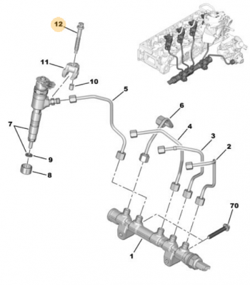

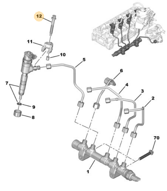

What's the part number for the stretch bolt holding the injector clamp please?
x 6954
Re: Engine problem (was Flywheel problem and was Fuel injector 1.6 Blue HDi)
If Item (12), part 1982 G5, (M8 X 125-59), £2.45 inclusive.
