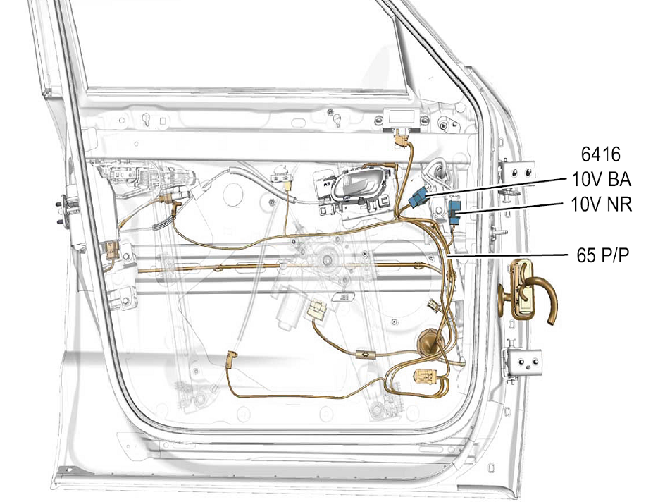

The blind system has nothing in common with the repeater circuit. If you pop up your VIN I'll be able to have a look at the wiring for you, but likely suspect is a trapped wire in the door bundle. The wiring on these is very brittle.

The Blind spot monitoring is linked to the parking assistance ECU Bernard. I've also checked the earths for the side repeaters and the blind spot monitoring and these are also separate earthing points - but of course all the door wiring for the door control module, windows, mirrors and other kit all have to go back through that door harness and back to the BSI at some point. I have seen some pictures in the past of the cut wiring at the door hinge point where this goes back into the engine bay, and also of the main wiring bundle in the engine bay, once the battery and engine fuse box is removed - the stack is obviously too tight and the strain just causes some of the individual wires to tear through.
The only way you can know for sure is to probably get an auto electrician with good knowledge of full CAN architecture systems to trouble shoot and trace the issue. There are a lot on interconnected harnesses here that makes troubleshooting a nightmare without the right tools. Your Picasso has the full electronic architecture, so is more complex. I only suggested that checking the door harness to engine bay wiring bundle as that would be the common factor / area for 2 separate systems to go down in the same location. The problem could of course be further down the line in the harness as I mentioned earlier.

The only things in the doors related to the blind spot monitoring is the actual notification symbol that is a simple on or off connection. All the other gear is in the forward and rear mounted ultrasonic sensors on the bodywork. So as the particular 2 wires to the alert symbol aren't multiplexed connections, it is unlikely to be too complex. but of course a break will do it!

In the absence of a message or warning that the system is malfunctioning, then it will likely be down to the wiring connection at the mirror or through the main door wiring harness in the door aperture which is a weak point due to the door opening and closing. Other possibilities can be the mirror glass itself (diode has failed).

How easy is it to inspect the wiring coming from the engine bay into the door? The flexible rubber sheath feels quite difficult to remove and there isn't a lot of room in there. Same with the mirror housing, I have been unable to remove that completely.
