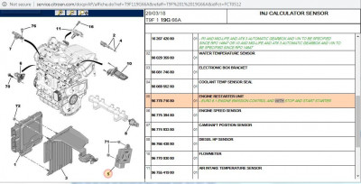

There doesn't appear to be a speed sensor on the manual box, just a neutral sensor. These are the engine sensors:
6 is the crank sensor. 5 is engine re-starter unit, not sure what this is or where is it mounted.... costs £115 though!!
