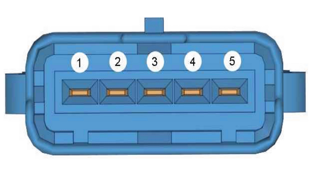

No user replaceable relay. The relays are R4 & R5 in the engine Fusebox - but these are sealed. Fuse F12 (30A) might be worth checking as the integrity of the internal fuse wire can be questionable. As I mentioned these have a master / slave relationship. Once the ECU inside the wipers get water in then they can play silly bu**ers.
You should have a fault code in Diagbox - if you put that up, I can advise. Is it both wipers, or the left, or right?
For info:
"a" Windscreen wiper motor.
"b" Windscreen wipers ECU.
"c" 5-way yellow connector.
The windscreen wiper ECU "b" interprets the wiping speed requests from the built-in systems interface (BSI).
The windscreen wiper motor "a" applies the wiping speeds indicated by the windscreen wiper ECU.
Functions of the driver’s windscreen wiper ECU (master):
  • To receive the wiping speed reference values from the BSI1 on the LIN, via the engine compartment fuse board-fuse box (PSF1)
  • To control the driver’s side windscreen wiper motor
  • To control the passenger’s windscreen wiper ECU (slave) via the connection between the windscreen wiper motors
The passenger’s side windscreen wiper ECU controls the passenger’s side windscreen wiper motor.
The windscreen wiper motor transmits the rotation movement to the windscreen wiper blade via an internal mechanism.
Each windscreen wiper blade has its own motor and its own ECU.
Here's the Electrical Pin outs:
5-way yellow connector (Left Hand)
Channel n°Designation
1Supply
2Earth
3Motor control via relay
4Communication between windscreen wiper motors
5LIN
5-way yellow connector (Right Hand)
1LIN
2Communication between windscreen wiper motors
4Earth
5Supply

Thanks for the info Marc Next time it doesn't work I will check for power on the fuse. There was no evidence of corrosion on the connectors although there was a little on the case. When they work they work perfectly and don't miss a beat, then suddenly they are completely dead, no amount of stopping and restarting makes any difference but I can use it a couple of hours later and they work perfectly.
All the other information I have found on the net relates to one side not working or only a small amount of movement, never had that and neither has anyone else apparently but mine either work on don't. Do you think its worth trying a reset?
