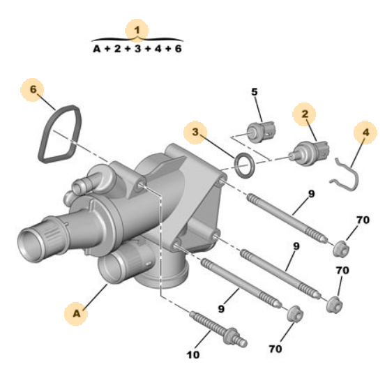

This is the outlet tank setup on your vehicle:
Part 1336Y9 for the complete housing. Currently £151.16 inc. VAT from Peugeot. There are aftermarket parts, of varying quality.
Or you can get the sensor (item 2) separately, part 1338C1, £49.63 inc.

Great, thanks. Do I need to buy the complete housing for this model? Any aftermarket brands that have a good reputation around here?

Is there a part code for the thermostat on its own? Or does Peugeot not supply the thermostat separately? Prices seem to range from £20 to £150 for the full housing. I'm wary of going for the cheapest units, but if there are good value alternatives to the OEM part then I'm happy to give them a go. Likewise if there is a decent thermostat that can be bought on its own (assuming there isn't some gotcha relating to the installation).
