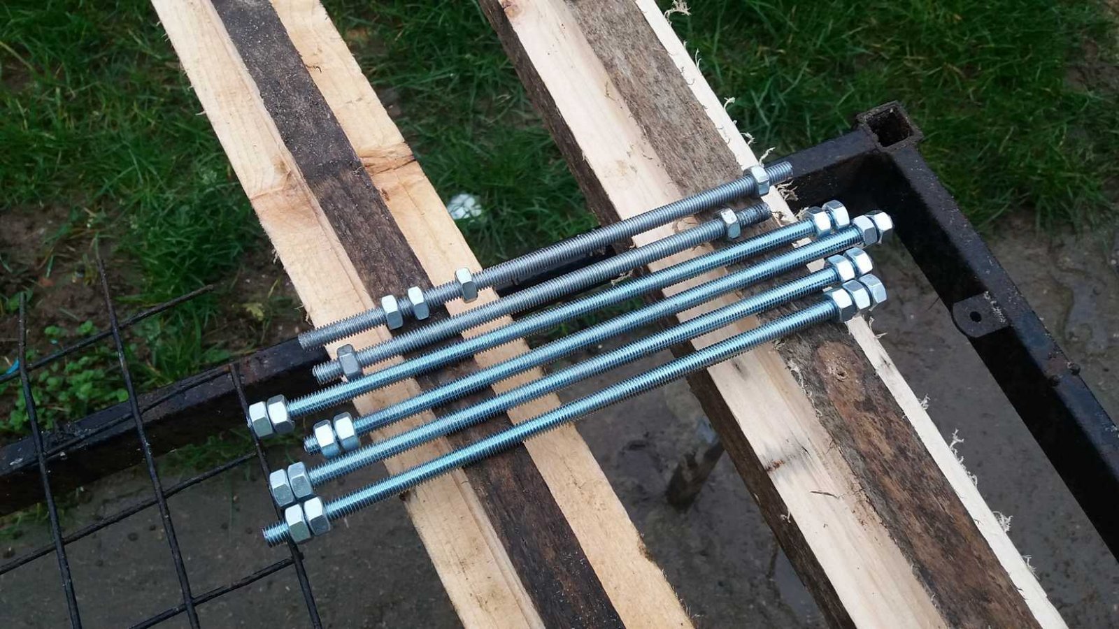

In other news.....
Can you guess what it is guys?
I don't think it'll take much working out. What d'ya reckon are my chances its gonna be effective? PS:

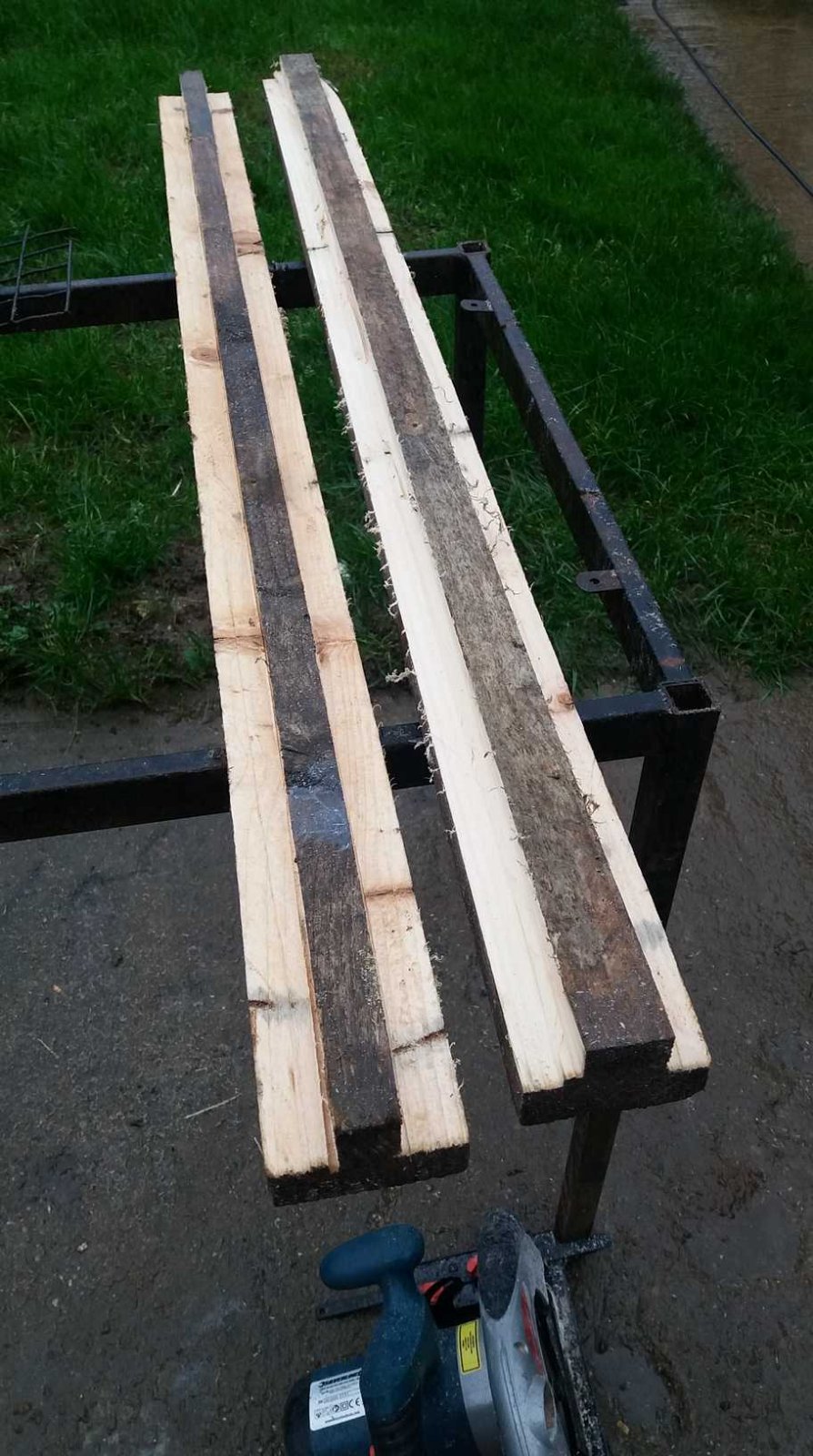

1: its not finished yet, one bit 'll be getting Drilled, the other will get a Routed Channel down its middle
2: the slightly different widths relate to my 'trial & error' approach, any more that I make will be the same

I think it's actually a multi-purpose kit, to form all the above... In no way is it possibly a Peugeot 206 Boot floor-straightening jig set though

Not death ray...

The central channel intrigues me.
