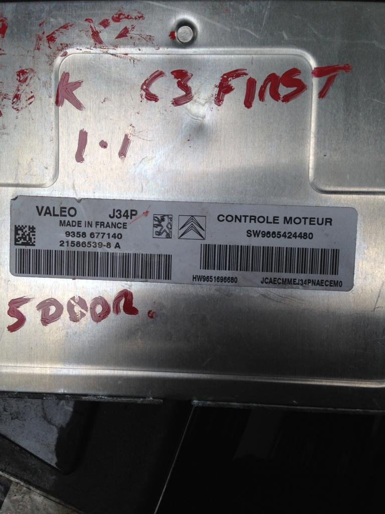

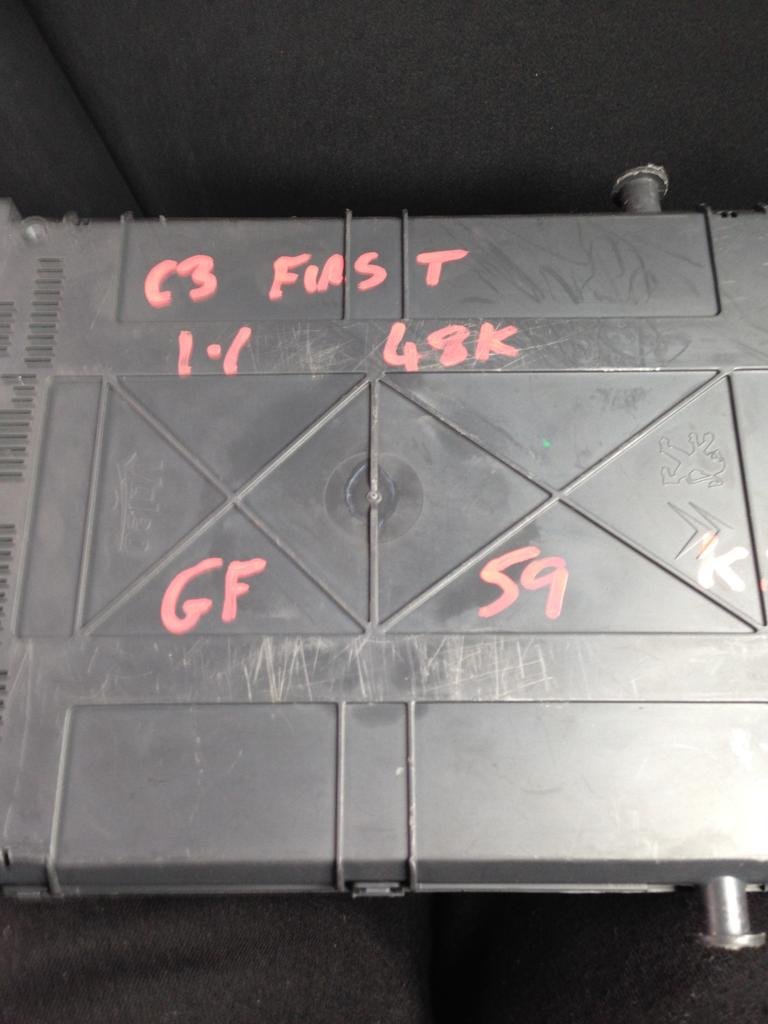

Can i post pic of what's fitted
thanks dips
thanks dips

Re: Citroen C3 2006 Central Locking Not Working
Ok so your vehicle is a 1.4i 75 (TU3A) engine
The donor vehicle was a 1.1i 60 (TU1A).
So that's one reason why you will be having issues, so the wrong engine ECU was fitted.
Your BSI part: 6580X4, 6580NG or 6580X5
Donor BSI (assuming this came from the same donor vehicle): 6580TR, 657079 or 6580TS
So as you can see both parts are wrong.
So you need to be looking at least for a C3 of the same engine as your own to be on the safe side and then when you have located one, check the part numbers of the engine ECU and BSI. Then that will at least get it to the stage where the parts are correct.

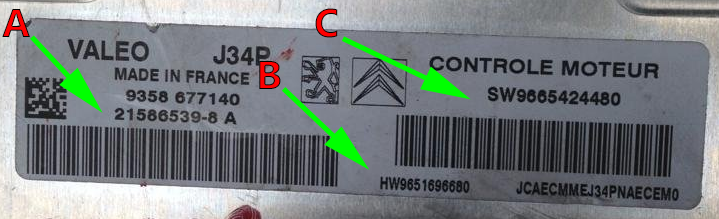

This is going to be the issue:
Normally, if one needed to replace an engine ECU or a BSI - they would have the label (as per your last photo) so that the Manufacturer part number could be seen (A), along with the hardware version part number (B) and also the software version (C), as I have shown on your picture below:
This would ensure the correct part and that the hardware and software versions are also the same. Unfortunately if you don't have access to your original ECU or BSI, the original Citroen part number is not enough to go on, as these would normally be configured at new to your car. The same Citroen part may have different hardware and software versions - which is why the VIN is specified on order for a replacement.
Without this, you could search on the Citroen part ' 1939JK' or '1943FL', but that won't guarantee the exact hardware and software for your specific vehicle.
Most decent re-sellers would ask you to match all the codes (as per the photo) for an exact match.
I think this is one reason why the last person installed a non-100% compatible unit and BSI set - as the original codes were not properly matched.
