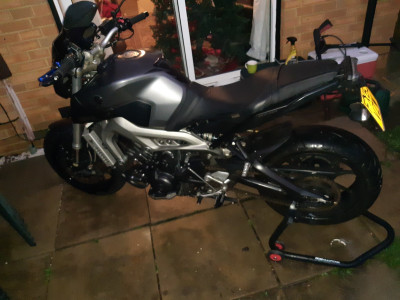

Get a can of ACF-50.and liberally coat all those exposed relays and electrics with it - and anything else you want to keep from corroding.
Developed by the military to protect jet engine blades from corroding and airframe surfaces. Loved by winter bikers and caravanners. Spray it *everywhere* apart from tyres, levers and brakes. Leave for 24 hours, wipe off excess, never wash the bike again over winter. It'll get filthy of course, but the ACF50 creates a water resistant, rust-attacking, corrosion preventing layer. It appears to be an oily gloop, but is far more than that.
https://www.airpart.co.uk/page/acf50?ne ... _kwd=acf50
I've just slathered my bike in it today!
