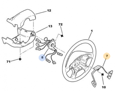

This system has the separate remote harness and buttons as shown below:
No longer available of course (Item 7 on the diagram, Part 4112FA)
There's a brand new one here for £19.99:
https://www.ebay.co.uk/p/Citroën-4112FA/659103708
I suspect the contacts on the button may be worn - a clean up may be worth a shot, but Lexia should be able to test the button presses for you. With the constant turning, it may have caused a break / tear on the ribbon connection also causing an intermittent issue.
Here's a better picture:
