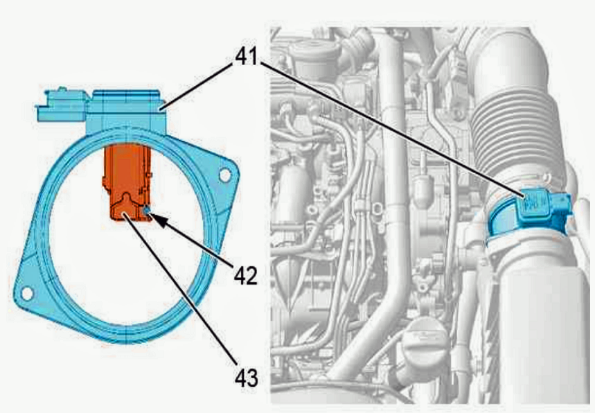

However, from what I can see P0104 is specifically triggered by the Air Flow Meter (MAF). Something isn't working right - so that the frequency reading being sent to the engine ECU is incorrect and is causing the problem. It could be either the MAF itself, a leak in the air hose going to the MAF so that the readings are incorrect, an electrical connection to the MAF etc.
Until I have VIN confirmation, I'm going on the 2.2 175 engine here - so will have to confirm this still applies once you have provided the info.
The MAF (41) in the 2.2 175 engine has 2 sensors - the inlet mass air flow sensor (43) and the inlet air temperature sensor (42).
Air Flow Frequency:
This varies in relation to the Air Flow - lower frequency for more air entering:
Frequency = 11000 Hz: Engine stopped, ignition on (No air flow)
Frequency = 5500 Hz: Engine idling (Medium air flow)
Frequency = 1000 Hz: Engine full load (Maximum air flow)
How this affects the Engine ECU:
From this information the diesel injection ECU determines the following parameters :
So you can see from the above how it can affect the Turbo Pressure - so I would keep focused on the MAF before swapping other parts to be honest as this is specifically what the fault is pointing too. When you clear the fault codes, that won't do anything - the fault will appear again as soon as the conditions are right to trigger it and this will depend on the amount of air flow entering the engine - hence why it may be stalling when idling or coming to a standstill.
I would get some MAF cleaner first (don't touch or brush the contact wire with anything except the spray or you will knacker it). See if that solves the issue - then check the hose for leaks / splits / cracks and then the electrical connection.

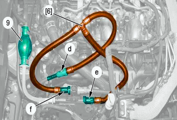

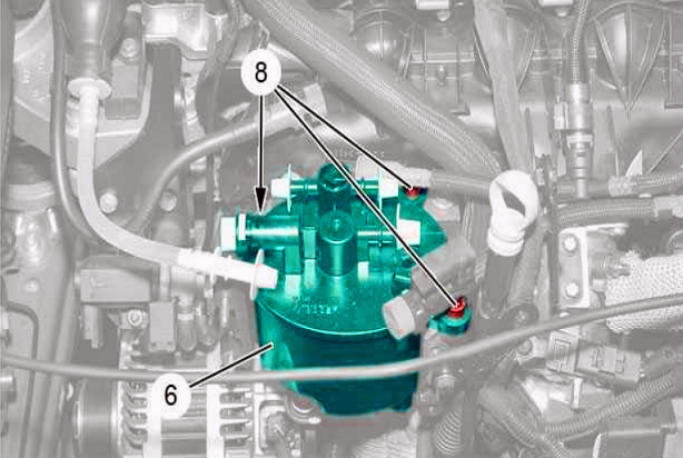

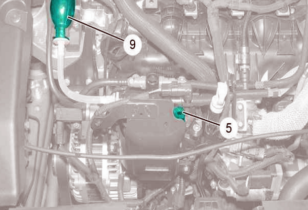

Here is the full procedure for this engine (DW12BTED4) 2.2 175.
Removing & Refitting the Fuel Filter
Tooling
Disconnect Battery! Procedure (BSI Reset / Battery Disconnect / Reconnect Procedure)
Remove:
Refitting
CAUTION: Only open the sachet containing the new fuel filter just before fitting.
Refit:
Couple the pipes (1 - 3).
Reconnect:
Checking the Seal
CAUTION: After actioning 10 times on the priming pump (9), the engine should start within 15 to 20 seconds.
Reconnect the battery. (refer to reconnection part of the previous Procedure linked to above)
Operate the priming pump (9) several times (10 times).
Start the engine.
Check the absence of leaks.
Refit:
This operation applies only during routine servicing, but is included here for completeness:

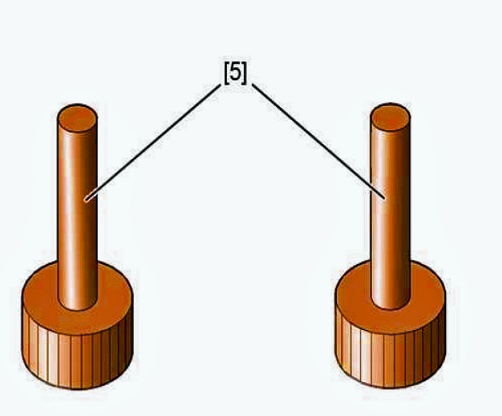

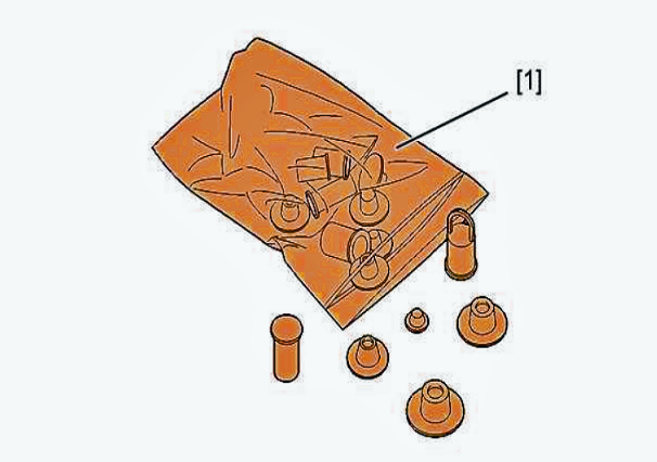

| Plug Kit | SODIMAC Cleaning Product |
| Union Blanking Covers | Filter Draining Connector |
