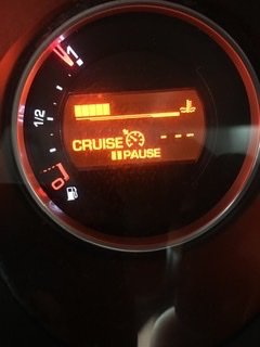

A quick query regarding the engine temp dashboard readout please. On the bar graph I’m getting generally 5 bars. It occasionally drops to 4, and occasionally rises to 6 bars. This equates to maybe just under half scale. Is this correct?
I ask because I’ve seen pictures showing 3/4 scale on the bar graph and the vehicle is somewhat heavy on diesel.

Mine sits at the bottom, only rises to the centre mark when crawling along in heavy traffic, I ignore it, it never actually overheats or consumes any water, never needs a top up.
I'd guess the sensor is faulty, as said in an earlier post that seems to be a common problem on these, had to replace one on my previous C5.

Mine both run at about 4 or 5 bars depending on ambient temperature, or at least they do now I have replaced the thermostat in one of them. If the thermostat is faulty it will show up best on a long descent in very cold weather when if faulty it could drop to 1 or 0 even, that's what mine was doing but since replacing the stat it reads the same as the other one.

Don't panic about it - there are other warnings that will appear if there is a problem, including the stop lamp.
The first 11 segments are normal and are within the normal operating range.
"P" Valid temperature zone: The temperature is correct
"Q" Excessive temperature zone: The maximum temperature warning light and the central STOP warning light come on, accompanied by an audible signal and a message on the instrument panel display
