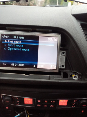

Just tried to retro fit sat nav to my 2009 C5
All went well until the screen booted up and the last 1/3 rd of the screen is grey in colour and not black (on boot up)
Has anyone had this problem?

Possible compatibility issue.
What head unit are you fitting and do you have a compatible screen for that Head Unit? There are low and high resolution screens which have to be compatible with the Head Unit. I'm assuming you are retro-fitting an RT6 (eMyWay) unit and not an RNEG (MyWay).

Looks like MyWay to me - or then eMyWay graphics is just the same?

MyWay has an SD card slot on the front of the unit, eMyWay (RT6) does not. They each require different screens to work.
You can just see the difference on the Telematics images for each on the home page of this section:

Hi
Thank you for the replies
The unit does have the SD card in the front
Could it be the data cable?
The unit and screen were removed from the same car
Regards

Ok, so if they were working as a pair they should be fine.
One thing that can brick the display is if you do not remove the quadlock connector first before the other cables and certainly before the LVDS cable that connects the screen. The Quadlock contains the power and if the multifunction screen cable is connected or removed whilst the quadlock is still connected, it can damage the display.
The Quadlock must always be removed first and connected last.
