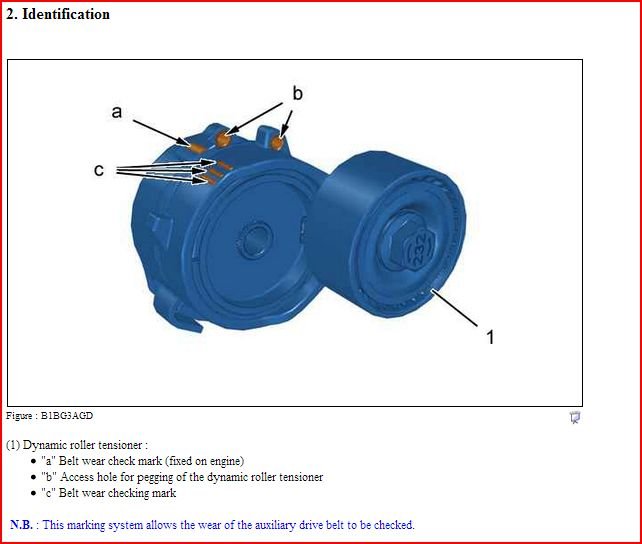

It looks to be... If it's got A/C then it's a spring tensioner, and there are marks on it to show the state of wear (presumably belt stretch):
If no A/C, then it's elastic, so you just cut the old one off, then use an appropriate fitting tool to wind the new one on. The belt is £37 from the dealer, but book time is only 0.3 hours so not sure where they get £117 from!! There is a second belt behind which drives the water pump, maybe it's this one - it's another £14, so the two together, plus an hour's labour might make up to £117. If this needs to be changed, again it's elastic, so cut the old one off, remove the aux belt tensioner, feed the belt behind the crank pulley, then wind it on the WP pulley, again using a suitable tool.
