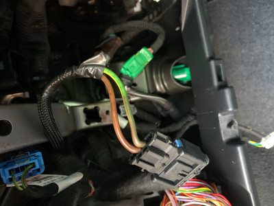

Re: Heater blower fan
ALL FIXED!!!!!!!
put my old "broken" controller in and it worked fine after repairing the earth.
for anyone who iss interested, if you remove the glovebox there is a black connector with a brown and earth colour wire (green and yellow), this is on the left hand side of the glovebox to the right of the spaghetti of wires.
this for me is what was burnt out so i cut the earth either side (never at the connector , give some extra just incase). and spliced together and worked a treat.

Seancombs
- Posts: 5
- Joined: 21 Dec 2019, 16:47
This photo is the wire which was burnt out, see the discolouration.
